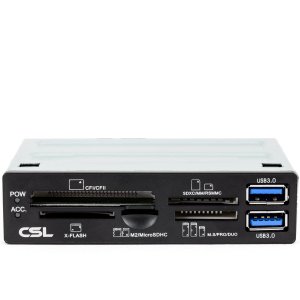

One of these will do it
^ Why would he do that and have to take out the SD card whenever he wants to write to or from the phone? Besides, if he wants to install custom ROMs he's going to have to write directly to the phone.

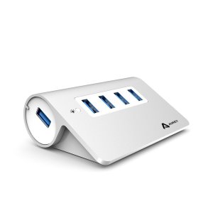

Tbh mate, I'd just purchase whatever is cheapest or whatever can come in handy for you in other situations as well (like a USB HUB).

As said before though, if you really do need to purchase a HUB or something similar as a solution, just buy whichever is either cheapest or handiest for you.
Thanks guys, I think I'll go with the cable for now, don't want to buy something that doesnt work.
