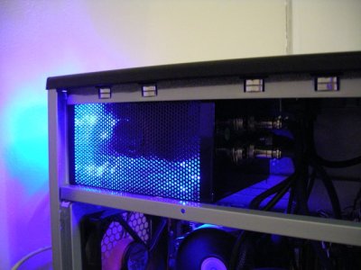

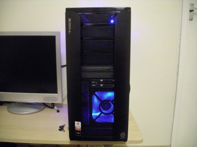

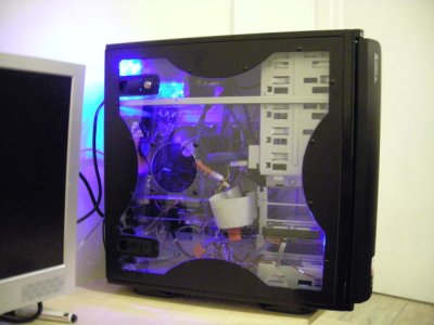

Pics as requested :) I took them with my Nikon Coolpix L12 (7.1MP). I had to reduce the size by a massive amount due to the original quality. I'm amazed at how well the pictures came out considering the bad lighting in here!
Anyway, first and second pics are of the front and side, third one is of the PSU.
I have a lot of tidying up to do in there, and plan on replacing the IDE and SATA cables, as well as using spiral wrap to bundle the wires together. At the time, aesthetics were less of a priority than getting it running!
I'm looking forward to seeing the end result (if there ever is one), especially when I can compare it to the old dull grey and black case!

Tidy those cables at once :p
No excuse if u have a modular psu :p :p
Just try hiding the cables where theres space (above the psu, in the optical drive cages etc.)
Pretty good first build mind you
The PSU cables aren't actually that bad, it's the rest that are the problem :p
I've ordered an AC Ryan Flexsleeve kit in UV blue, along with a blue rounded IDE cable (hate that standard ribbon) and a blue 90 degree SATA cable. I also got a couple of 12" AC Ryan blue cold cathode tubes to light it up once it's tidy.
I do like the idea of hiding the cables in those places though. I'll try that once they are all bundled together.
I'll post an updated pic once I've tidied it up ;)
