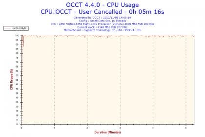

i am noticing my cpu going from 4ghz down to 3.5ghz at stock when i run occt is that normal?

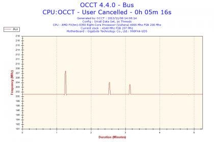

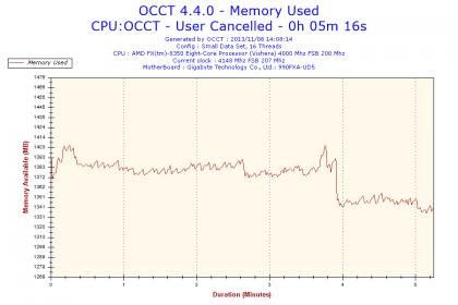

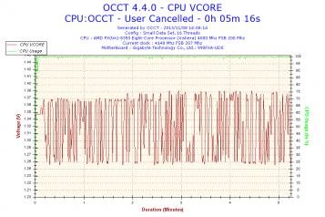

I have an AX850w Corsair, so i think i should be fine :huh:. thanks for the input Guv
haha yeah i know the pics i posted were from stock, no overclock on at all fella.
Did you disable cool and quiet? Still need to manually set volts etc.
if 4ghz is a turbo speed the MHz can go up and down as needed.

no 4.2ghz is the turbo guv its the fx8350, an yeah cool an quiet is off so is turbo mode

yeah its at stock volts 1.32v, an yeah i have read that guide multiple times an the same with the vid
