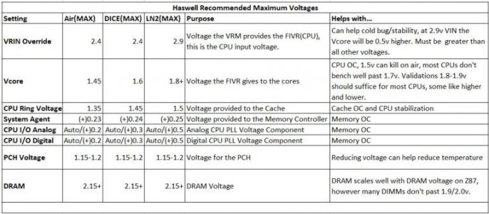

These are the ONLY settings I've changed so far, and it's all been done within Asus UEFI BIOS (updated to v 1502). I've been working to the rule that I don't want the VCore above 1.3v really (I've read that 1.5v would undoubtedly kill it outright on air). I've also attached a Haswell guidance sheet which I found online somewhere. But I've been looking at it with caution since I simply don't know who put it together or how reliable the info is.
