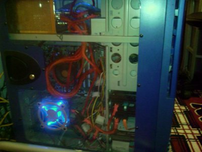

naw its pci-x, and nope no sound card, i use onboard. dont know if the pic is gonna work or not and might be kinda big too, took it w/my 3.2megapixel camera phone. i have most of those lil wires towards the front. i order some thermal paste to redo it

The cooling looks poor at best. Try to bundle some of those wires away from the airflow.
I cant tell by the pict , is the fan mounted in the side panel blowing air to the Video card or blowing out of the case?
Also that HDD rack blocks 75% of the incoming air (also not too good)
What are the temps with the side cover off?
Well, thet's my ideas out the window:p
Yeah, I'd try bundle some of them wires up a bit. Try bundling them up above the level of the gfx card. You could strap them up to one of those holes that are in the chassis above the HDD rack.
well i redid the wires the best i could, took the card out and blew it off, plugged everything back in and now its running at about 68c now give or take a couple. the fan on the side of the case is blowing towards the card too. all the old psu says is Rosewill Performance RP550 and i know the rosewill when i was using it didnt have enough power so the card automatically lowered its performance so the warning siad when it poped up on the screen whenever i rebooted. but this Hiper Psu doesnt give that warning.
