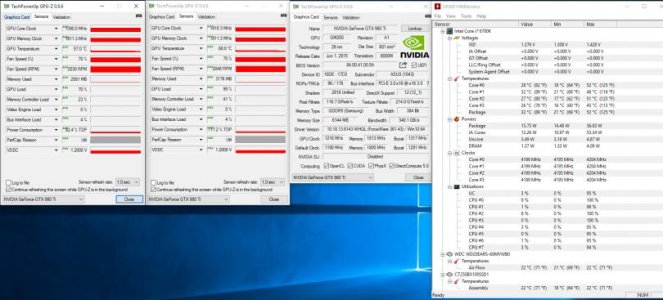

Hi all.
I am unsure about the results below. I have not changed anything and its "out the box" except turned to its OC mode as advertised of 1216/1317 and adjusting the fan speed. If fans are left on auto the card reaches around the 75c mark but the overall max boost is lower.
In order to keep the card below 70 I need to have the fans turned up to 70% is this right? I thought the cooler on this card was meant to be good. I have a 360 aio taking care of the CPU and this tops out around 40/45 on stock.
I have 3 intake fans and 1 rear although these are not controllable along with the 3 aio fans which are controllable and i have been playing with the speed of these.
Case is h440 tried with and without the front / top though it becomes rather loud with theses off.
Also the card only has a 69.1 asic score is this not a little low for a £650 card? And the memory is a different brand to the Oc3d review whys that? Mine says samsung and the review had hynix. Also how do i set the speed to be default as mine says 1190/1291
What i am concerned about is if im at 70% fan speed already for 70c then really this is not leaving much room for an ovc on top. As i do not want a card running at 80/90% fan speed.
The whole point of buying this card and spending over the odds was for its "good" cooling and out of box speeds with it being classed as a good overclocker too but as yet I have not touched a thing and I am almost running the fans at full speed.
Tested with a game for one hour rather then benchmark
http://s29.postimg.org/ug4srqrvb/Capture0.png < incase the image is too small to view
75°C for an air cooled 250W TDP card in an enclosed space is quite impressive. As long as it stays below 80 it will run at it's highest possible boost clock so getting it to run cooler really won't benefit much and will probably just make your rig louder.
Samsung memory is generally superior to Hynix so that really is nothing to complain about either ;)

asic score is like the cpu silicon lottery. you dont have any higher odds than anybody buying a 960 or 950. its just luck of the draw.
Like others have said, 75C with the fans on auto isn't too shabby, only worry about it if you decide to start overclocking or if the heat build up in your case.
Your ASIC quality is about average to be honest. My stock reference 980Ti's have low ASIC (62.9% and 66.4%, see image below) and it took a BIOS flash with extra volts and watercooling to get them to sing. Afterburner is my method of persuading them even further :).

your cards have an overclock higher then my stock but your fan speed tops out at 50% each. Also u have stock reference cards, i paid the top price for asus flagship card, I want better then average else i could have saved my self £150
I could understand the high fan speed if i had overclocked further on top of the stock speeds but if i add anymore heat from the graphics card via overclocking, i will be in the 80 - 90% leaf blower range and the heat will be more then what it is now.
I did say they were watercooled, or more accurately hybrid :), hence the fan speed (which is only that high due to benching, usually only 30%).
You have by no means got a runt of a card, just drawn the medium of straws.
If you're feeling brave, take off the cooler and replace the thermal paste with something better and more carefully than the OEM. If it's anything like my reference cards who's method was the envy of Polyfilla, you may lower your temps a bit.
