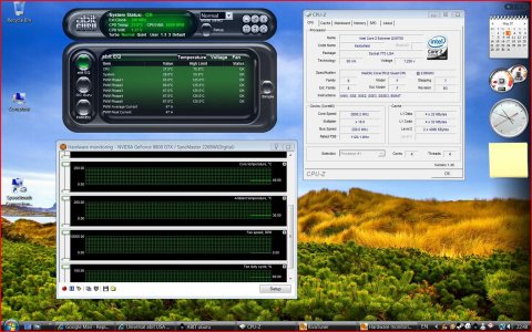

The above method + living in country side + getting up early with windows open =
(*whispers* I think it's wrong)
WOAH! llwyd that is awesome! I hope its correct, cos that is cooool! :p
That's beside the point, the creator of CoreTemp has said there are issues with CoreTemp reading E4300 temps very low. I'll find the post for you. :rolleyes:
