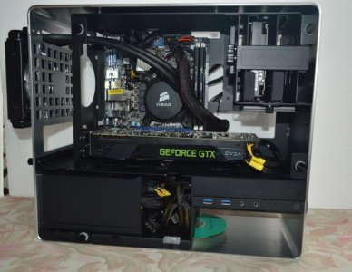

Taking the LHS glass panel off reveals your first real look at the inside and how it is set out.
In the middle you have your motherboard tray with large cutout.
Just to the left of this is where the rear I/O shield fits and behind this is gap before you reach the rear removable plate.
This is to allow cables to be fed from the I/O panel through the hole in the removable plate, but there may be an issue with this that I shall come to later.
The gap between the rear of the internal chassis and rear of the case may just fit a 120mm AIO watercooling unit, though I have seen more mounted on the rear of the case, unfortunately I did not have one to try.
Bottom left is where your power supply bay sits, which is fairly substantial for such a small case. Below this is the floor of the case where a slimline optical drive can be fitted, In Win have pre-installed a PCB with Sata cables for ease of mounting your O/D if required.
Top right is your hard drive bays, two are hot swap varieties that enable 2.5 or 3.5inch HDD and there is a further mounting position for a 2.5inch drive on the LHS of the bay.
To the bottom right you can now gain access to the fan bay.
This can be opened by loosening the sprung thumbscrew and sliding open the drawer.
The case when purchased new does not come with any fans fitted so would highly recommend fitting both 120mm intake and 92mm exhaust fans to aid cooling.
Spinning the case around and removing the other panel and rear plate, we can see the naked case and the form of the aluninium sculptured chassis.
You can now see the Hot swap bays with their connectors and the large motherboard cutout and psu bay.

So, to the build.
My current watercooled gaming rig is due for an overhaul, with this in mind I intended to transfer the majority of my hardware from my Bitfenix Prodigy into the 901 as a temporary home.
Here is the Prodigy next to the 901 for size comparison:
Firstly I installed a Corsair CX500M, being of a semi-modular design was a plus, although if using a non-modular PSU you may still be able to fit most of the un-wanted wiring in the PSU bay if using a standard ATX sized PSU, anything longer and I would definitely recommend a Modular design.
The PSU bay has a sticker on it to warn you to have the fan facing up, this would of course be due to no ventilation if faced down.
I fitted the ugly standard Intel fan and heatsink to the motherboard as I did not have another heatsink that would fit, the clearance for CPU heatsinks is stated as 130mm for this case.
The fitting of the I/O shield I found a little fiddly but nothing to awkward, and the motherboard went in easy.
I then attempted to fit the front I/O connectors and found my first problem.
I routed the cable behind the motherboard tray and up through one of the cut outs nearest the motherboard connectors. The cable could have done with being 10mms longer. It was a real struggle to attach the connectors onto the pins and was quite weary of possibly bending the pins in the process. I did however manage it eventually. This could of course be as much down to the positioning of the pins on the motherboard as to the length of the cable, but I thought it needed a mention.
Indeed some ITX motherboards may have a more difficult time fitting dependant on pin placement. This may be a deciding factor upon hardware choice if you are torn between a number of mobos and really want to use this case.
The motherboard used for this build MSI Z77IA - E53
The hard drives I used were both 2.5inch, one SSD and one HDD, both were fitted into the hot swap mounts easily.
The HDD cage has a brace across the front which is held by a thumb screw, this releases the brace like a door to allow access to the caddys. Theses are just pulled free using the angelled metal handle, the hard drive can then be mounted with screws and pushed back into the bay.
The graphics card I installed was a Palit GTX 970 which fitted with plenty of room to spare. The length of graphic card is not a problem with 300mm of space. The width of some may be though as this particular graphics card is not the thickest but only has about an inch of clearance from the very bottom of the chassis.
Another note on gpus for this build is that I believe due to the lack of clearance for fans and small internal space a single blower type fan would work best, giving greater airflow from the one fan positioned over the case fan and chucking the heat outside the case.
For this build I also did not have a slim O/D to try out so can not comment on the ease of this.
Cable management I knew was not going to be that easy in such a small case, but there is quite a lot of room behind the motherboard and also some space if needed in front of the PSU. The fact that the hard drives had connections fitted also helped.
However, with the side panels being made completely of tempered glass there is no lee way or give like steel panels.
For this reason you have to be meticulous in ensuring all cables are inside the boundaries of the case, the most difficult part for this build was the GPU cables.
This is another area where choice of hardware may need to be made due to the constraints of the case. Luckily the Corsair power supply I was using has flat flexible cables, though this was difficult enough bending them to comply with the cases dimensions to get the panel back on, PSUs with thicker cables may find it even more troublesome. My recommendation would be to go with some aftermarket individually braided cables which would most likely be a better fit.
So, after many hours tweaking and squashing cables, I was able to put both panels back on and fire her up.
Looks great but who turned the vacuum on?
What a noise, I think the person who sold me the case must have wanted to get rid of the fan that was in it.
I decided to change the fan for a quieter one.
This proved more difficult than it should have been. The screws for the fan were not fitted properly so caused a problem releasing the drawer. Though this is not a fault as such of the case, it is worth noting that when fitting a fan the screws need to be flush with the draw as there is little space for them.
Once prised open I changed the fan and screws and proceeded to thread the wire through the back of the case where the front I/O cables were, this was a bit of a challenge as you cant get your fingers inside from the back and have to do your best to hold the other cables a couple of mms to the side to enable you to thread the fan cable through.
For this reason I would recommend fitting the case fan before anything, this should give you more freedom to pass the cable through, and best to make the right fan choice to avoid changing once built.
Well at least now it was a lot quieter
