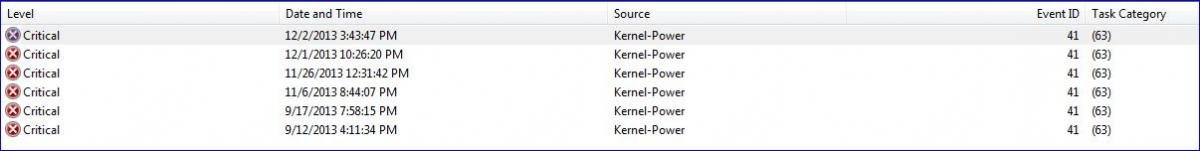

Looking at my system logs again and double clicking on the kernel 41 error i come across this.
http://forum.overclock3d.net/attachment.php?attachmentid=7173&stc=1&d=1386036313
(regarding the picture)Now sorry if you can't see it. I'll explain it if not..
Basically it has 6 total events of this kernel 41 error. Starting from 9/12/13 and the the next 5 times were on: 9/17/13, 11/6/13, 11/26/13, 12/1/13, and today 12/2/13.
Now i know this has happened before but not 6 times?
