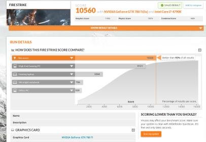

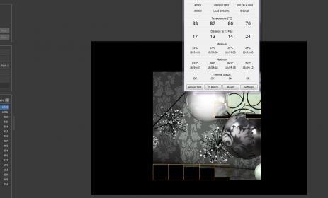

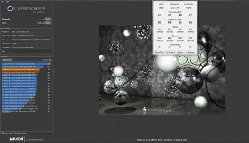

Bumped up the voltage to 1.34, Cache ratio to 45, XMP profile for the memory and let it boot at 4.9GHz.....and boot it did!
Went right into Windows without issue and was able to run Cinebench R15, AIDA64 Stress test for about 30 mins and 3dMark 13 Firestrike. The thing is rock stable but HOT. Temps were at 95 for most of the stress test but during 3DMark not 1 core broke 90.
This was a quick and dirty overclock just for testing and has been dropped to 4.5 until I get the water cooling stuff in BUT this was the easiest Haswell overclock I have done....EVER!
Pictures are below to show where it was during testing. I'll have more time to work on the voltages once the water goes in but it seems to be thermally limited. I really think with some time and tweaking, I can get her over 5GHz easy!
