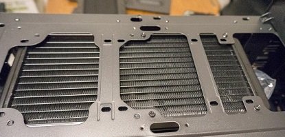

Anyway, I should take back the H110i not easily fitting the HAF X; it does but you can only use 4/8 screws, according to this bloke:
Just drill a few holes if it doesnt fit ;) Only take a few min at most.
