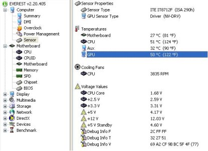

Ok here goes - I have a Gigabyte GA-7N400-L motherboard with nforce 2 chipset. I've heard that the temperature readings on these motherboards are higher than usual (I've heard a rumor that it reads from the very hottest part of the chip?).
I've got an 80mm fan on the front of the case drawing in air and 1 on the back extracting, also the PSU has 2 fans on it extracing heat. While idle Everest reads that the cpu is 52 °C (126 °F) and GPU (which I am fairly certain is my graphics card) 51 °C (124 °F). Both go close to 60 °C when playing CS: Source. I also have stock cooling on chip and my 6600gt BTW, which I am looking to change!
Surely this is too high? :confused: I have also taken a screenshot of the idle sensor readings from Everest. Could you guys shed some light on this please? Thanks guys, much appreciated! :D

i think that the temps of the gpu are quite correcct afaik, for the cpu well yo0u should wee to do something about it i doubt whete idle 52 , mine is stock speed and fan , idle 35 , load 46 so hmm quite high for not an oced machine
EDIT why is your vcore 1.68
temps seem faesible jiffz.
yep vcore is high, but can you check it for us in BIOS b4 we assume please :)

Temps seem a bit high having had an XP system myself. I think maybe a sensor put into place may be a good idea :)

But I really cannot see why the hell my system would be this hot! When I put in the 2 fans it only moved around 3-4°C. I just think the sensors are off and I've heard they are up to 20 °C above what they supposed to be! So that would make sense to me that it's idle at around 30°C and the cooling couldn't do much.
Does dust cause a big problem to heating? I say this bcuz the heatsink on the chip is lookin a bit dusty. Any ideas for a good cooling system for the chip? Looking to spend about £20. I'm tempted to get an exhaust blower think for the 6600gt too, cuz I know the standard nvidia cooling is crap!

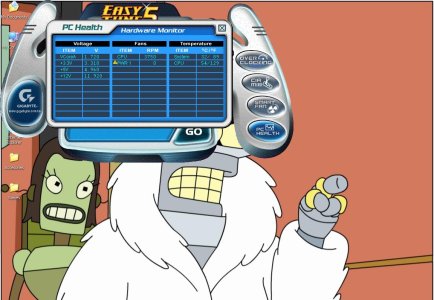

I've added a screenie (lovin the pimpin Bender background) of the Easy Tune heat stuff, so you canhave a different look at the voltages. I have no clue about voltages so could ya help me out with that? Thanks!!! :D
Your temperatures are exactly where they need to be. The AMD XP processor supports a maximum die temperature of 85 degrees celsius. AMD XP WhitePapers
With a stock heatsink (or a comparable aftermarket HSF) coupled with stock VCore (1.65v) your temperature reading of 65 degrees celsius sounds exactly right! You can raise your VCore higher but there's a thermal throttling diode on the motherboard that shuts off the computer in the event of a drastic raise in temperature. If you want to play with the VCore get a Swiftech MCX462-V HSF. That's about the best you can do for your money. Make sure you buy a fan that sucks air through the HSF... blowing air through the HSF is a bad move.
In case you're wondering, I wouldn't flirt anymore with the VCore if your peaking at 70C under load.

Use Speedfan
The stock VCore for an Athlon XP CPU is 1.65. My XP Barton idles at 48C with a MCX462-V and peaks at 55C. My stock HSF and crappy aftermarket HSF peaked at 62-65C. I bought my crappy HSF after reading a review about it in tomshardwareguide. You can't beat the Swiftech HSF. Thermalright has an SP97 and SI97 (impossible to find) and an XP90, XP120. I'm not sure how the latter two perform but I can totally vouch for switftech's HSF and it's not all that expensive.

I don't understand what lowering the voltages will achieve. Am I currently straining anything by leaving it on the current setting? BTW a little while back I found my FSB had gone to 100, I think this was caused by a pretty nasty crash. So wouldn't that mean the voltages would be at default/safest setting?

stock voltage = 1.XX
cpu runs fine stock speed stock voltage at good temps
ur voltage - 1.68
this is above stock voltage and is unecessary as cpu is at stock, so doesnt need extra power, its just creating heat for no reason

exactly!! i dont actually knwo the default voltage of ur cpu (ask kempm, he is stato with these things) so i put 1.XX. Either way i know it is less than 1.68.
