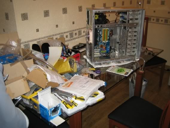

b*tches, Your not kidding. Just to give you all a laugh i have just tided up the dining room as i doubt i will get something sorted over the weekend so i won’t be able to touch the PC again until Thursday.
Pic of room AFTER tidying up
Hope no one comes for dinner :p
