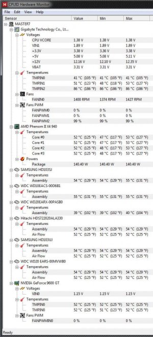

to help on the question, though depending on the actual temperatures, hard drive specs should
be between 28°-45°. keeping these in that range will extend the life of the drive. so super cooling
them is not in your best interst. monitor them with a hardware app (HWMonitor) and retest.
simply upgrading to a better fan, air-flow across the drive, or staggaring the drives in a rack can
offer simple cooling solutions to a nominal problem. but get us those specs and we can try to
elaborate a better answer.

ok after much fighting with the machine and discovering that hwmonitor does not like (in fact crashes in a bad way) my ide interface card or the four ide drive that hang off it, so this attachment is without those four drives
