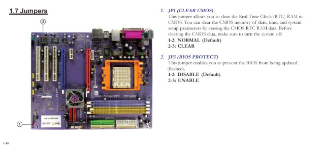

Before you do anything like that though, try taking out all the un-necessaries so you're left with your power supply, motherboard, FX53, ONE stick of ram, graphics card (if you haven't got on board graphics on the mobo) and something to boot from. Reset the CMOS and try again. Ive actually got the manual for this board already having accidentally downloaded it while trying to help a friend who owns an ECS, so.....to save you downloading the manual:
Just seen previous posts lol. if youre flashing the bios make sure the protection jumper seen below is set to allow you to flash it :)
