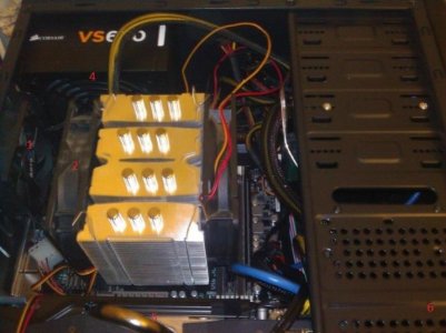

Possible errors you could check (sample image attached, fans marked)
Note: Some of this should be common sense but I#ve seen it all :/
Since Fan 4 will, in this case, alway blow "down" i will not address this further.
Error 1: Fan 2 and 3 are blowing against each other. Thereby warm air will go up- and downwards. Step by step everything will get hotter, fans faster etc. Not good.
Error 2: Fan 2 and 3 are both blowing richt. Fan 1 left (outwards) and fan 6 into the case. You won't get enough fresh air. Furthermore Fan 2 will get warm air from fan 4.
List goes on, but in this case you could:
Fan 1 is the exhause. Fan 2 and 3 are blowing air from right to left. 6 delivers fresh air. A Fan at the side willl also deliver fresh air. You have a steady stream from front to back and the only thing you will have to do is leaving enough space behind the case to dissipate the warm air.
Btw: this setup (AMD FX 8350) ran at 4,5 GHz with 15°C idle and 55°C working at full throttle. While making no noise at all most of the time. Fans: Scythe Slip Streams, Cooler: Mugen 4
Case was a Aerocool V3C BE, which is smaller than your mentioned case.

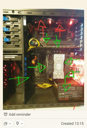

I can't see any problem with my set up. Just want it to be quieter and more efficient
Green arrows is intake
Red arrows is exhaust
Dead silent after some research and changes. No top exhaust as the gpu are intake.
front Intake and rear exhaust with two cpu fans pushing from left (front) to right (back)
