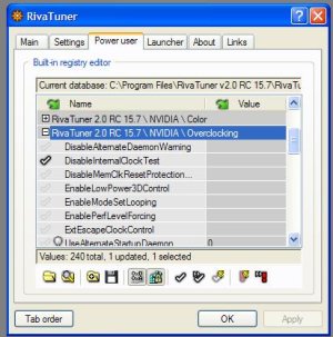

I had this problem with Rivatuner and my 6800 after unlocking. My solution was to disable Rivatuner's clockspeed testing, then it seemed to work fine (it's under power user settings)
And then later on, it just stopped bitching... so I was happy. :D
