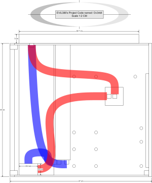

UPDATE:
This is what the layout should look like in theory but it prob not end up like that lmao :D :D
get.php
QUESTION: Is pump better at bottom fed by res, or pump at top suck from res? Will it make any difference?
Pumps are designed to Push water, it also makes it a hell of alot easier to fill a loop with the pump below the res.
I would have to say that it would be much better to have the pump located beneath the res, where it can be gravity fed it's supply. These types of pumps are generally designed to push water, not pull, hence being given a total max. head rating.
By placing the pump at the top of the loop it is placed under more load, as it is being made to work for it's supply. Also, there is a small chance of air accumulating at the top of the loop & settling in the pump.
pulling water up will slowly kill a pump and reduce its efficiency. put it on the bottom, just my 2 cents.
UPDATE: Well i've changed my parts list considerably lol! heres the new one:
  • CPU Block: EK Wave Intel Skt775 CPU Watercooling Block - Silver
  • Reservoir: Alphacool AGB4 Plexi 380 Reservoir
  • Pump: Alphacool Laing DDC-1T Pump Ultra with OCLabs Clear UV Blue Plexi
  • Radiator: Black Ice® GTS360 Blue
  • Fittings: 4x EK 1/2" High Flow Barb & 2x G1/4" Screw 45 Degree Angle for 1/2" Tubing
  • Piping: 2x XSPC High Quality 1/2" Tubing
  • Liquid: 2x Red F1
  • Fans: 3x Aerocool Turbine 3000 120mm Blue LED
New image attached
