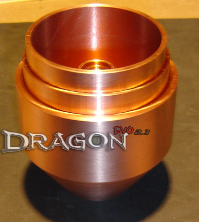

Dry ice is solid CO2. Its compressed and cooled from a gas too a solid. Too remain as a solid it needs too be kept cool. And therefore, at room temperature it starts changing phase from a solid too a gas (sublimates). To achive this it needs heat. Wich it will take form any availbie source. Ususaly the surroundings. But using special containers known as slugs, its used too cool cpus too rediculously low temps.
Ill dig out a PT chart wich will show some of the latent temps....
Thats one of kingpins slugs.

I've done a lot of dice benching. Dice gives around -60C to -75C base temp on a good well made pot, preferably a solid pot. Overall it evaporates slower then ln2, and is warmer, so is a good intro into ln2,or just for all time benching. Many benchers use dice on video cards as well though its not as easy to control temperature wise, as your adding pellet or ground up dry ice.
Both require refilling of course as you bench.
Don't pick it up with your bare hands either or ull get burned. So in recap, wear gloves, buy a nice aluminum dry ice pot, use a shot to a shot and a half of acetone or vodka in the base of thepot to improve surface area, and insulate properly.

i`d go for Copper over aluminium if the moneys there, and you forgot to mention ventilation ;)
I dont bother with gloves, I use a small cooks kitchen scoop and the card funnel shown in my pic and its sooo easy to work with :D
Yes ventilation, have a window :P
As for copper vs aluminum, under -90C its not worth the copper unless your really out for it.
