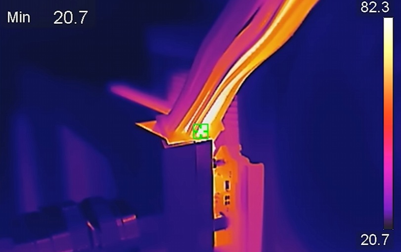

Pro overclocker uncovers "concerning" issue with Nvidia's RTX 5090 Founders Edition GPUs.​
Read more about der8auer's "concerning" RTX 5090 Founders Edition discovery.

It's not entirely safer simply to increase the size of the wire unfortunately... Buildzoid recently made a video on this as well, where he explained that the pins connecting the actual connector the PCB are thin and basically not up to standard as well. Hence overall, it's an garbage design that should never have been approved or actually have been heavily re designed instead of the tiny shortening and lengthening of some pins in the connector itself. Heavy facepalm moment everything surrounding this connector...

I meant it as an all around gauge increase in wire size. From connector to connector, whether thats the PCB side connector or the cable itself.
There's no excuse really. It is 2023 or 2024 whenever it all came out. We know how to make damn cables to handle specific electrical loads.

I have a feeling it may have been done to save money. If PCIE power connectors are anything like USB then the inventor of them gets a royalty for every one sold.
It's either that or nvidia trying to be cool and different or just vanity.

See that's the thing that I don't understand. EPS and PCIE are thicker wires in awg than this thing right? So it's a 16 pin so that's just two 8 pin with thinner wires.
