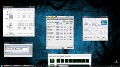

So I did some testing and this was my best stable voltage for prime!
I wasn't in the mood for start->BSOD's the whole time so I just use OS Tuner that came with my mobo! I set voltage to stock and then started prime..while prime was running I reduced Vcore then left prime running for 30min then dropped Vcore again. The previous screenie was usable but would prime for like 20sec:lol:.
So I don't knw if that is a good 2600k stock voltage or not. Maybe i should start messing with the PLL/Vtt voltages! I've got a fairly good baseline.

Okay wow that picture came out useless
Hope these show the important stuff!
