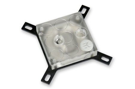

Does it matter which one of the holes i use of the cooling input or does it have to be the one closes to the center
normally the instructions will say or it will be marked on the block if it doesnt then its NORMALLY universal. But I'd recommend center in and side out. Thats how they normally go
You can use either as the inlet, but the centre most port is best. The difference between the two can be as much as 3 degrees.
If you are set on performance at all costs then it is a no brainer that you use the correct port that in most cases is marked "In"
Thanks for all the is info get it all work out i am a noob to water cooling so got there in the end now only 3 Graphics Card to block and pipe
