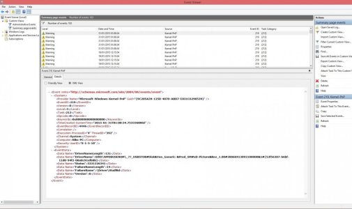

My computer (in the last few months) has started to 'lock up', what I mean by that is I will be using the computer and randomly it will just freeze, and I have to manually restart the computer. I have checked the events viewer but I really don't know what the problem is...I have attached a picture of the events viewer.
Any sort of insight will be very helpful.

my pc froze again, this time it didn't have my external WD 1tb drive, i have no other external storage plugged in. Event viewer showed the same message i think:
The driver \Driver\WudfRd failed to load for the device SWD\WPDBUSENUM\_??_USBSTOR#Disk&Ven_Generic-&Prod_SM#xD-Picture&Rev_1.00#20060413092100000&1#{53f56307-b6bf-11d0-94f2-00a0c91efb8b}.

Well I did a fresh install...installed the drivers from Asus, plugged in the external drive, it installed fine. Few hours later.....FREEZEEEEEEEE again :((( same s**t again:

However I went back into event viewer and these 'driver failed to load' (there were more than one i think all the usb devices) were just after I had manually restarted the computer. SO the freezing therefore has nothing to do with what I have been posting (my bad i should have looked at the time stamps). Ive looked through the entire event viewer and found nothing just before the computer locked up.
Possible hardware issue?
