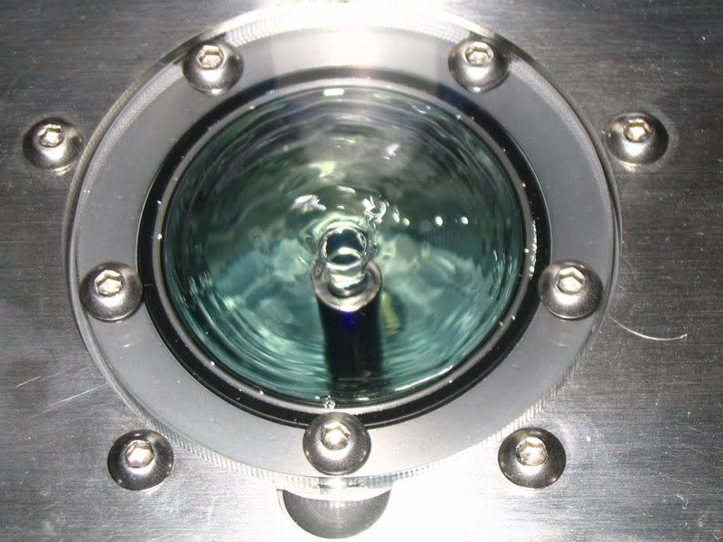

The reservoir is an Aquacomputer Aquaduct in black, I have to admit I was really surprised by the quality, its outstanding, the entire structure is machined from a single lump of metal the only plastic on this is the Perspex lid and o-ring. I opted for the G1/4 inch version which is equipped with a total of six ports, three on the base and three on the side. Currently I have a temp probe, the Aquacomputer RGD lighting module which can change colour based on water temp and an Aquatube for the nice visual effect.

Yep that's the res, the LED inside should change colour dependent on water temp and the aquajet will spray the water onto the perspex so it shouldn't mist up
Something like this:
