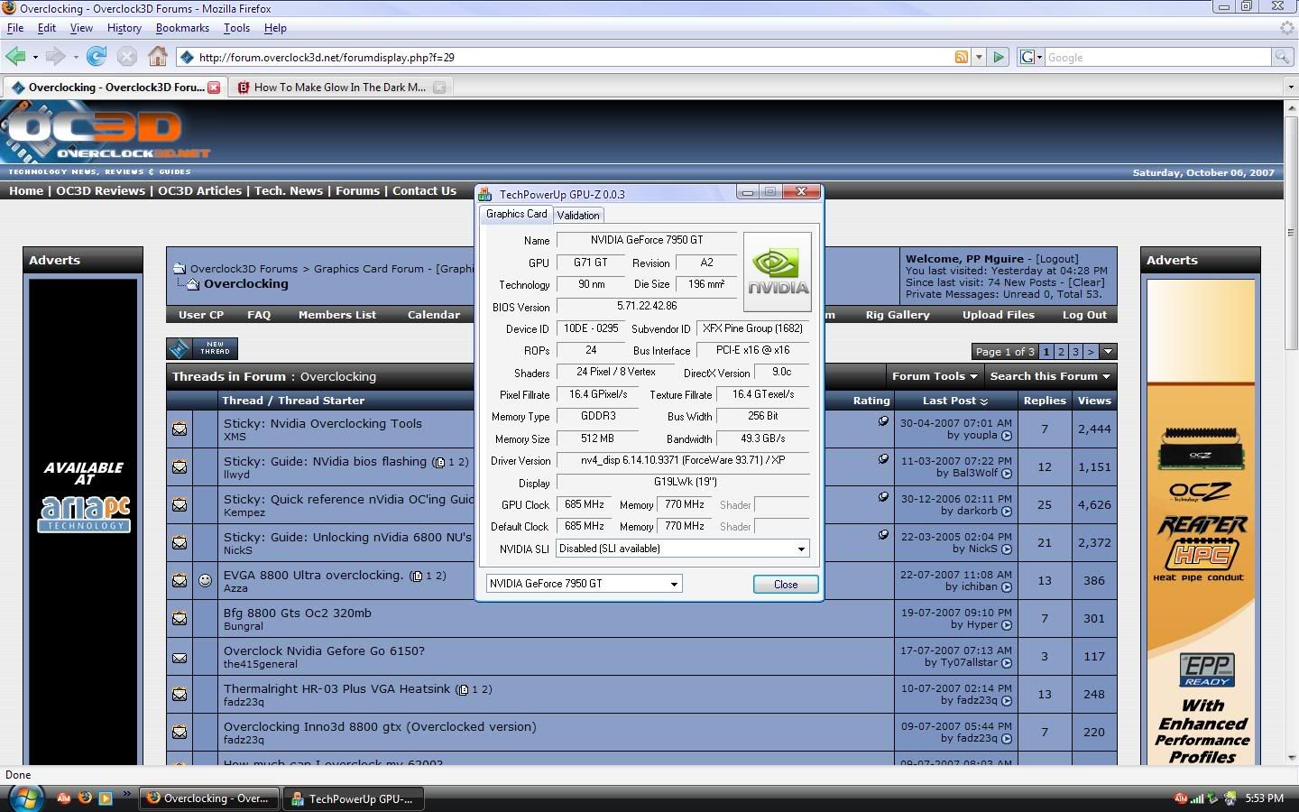

Whats the advantage of flashing the card, other than it being a permanent thing, than overclocking it using RivaTuner and setting it to run at startup?
Well flashing is permanent and not OS-related whatsoever which means that the card will have a permanent OC on it, like buying a factory clocked card
Yes thank you Kempez. See i run a triple boot system. And i use Coolbits instead which uses a registry entry. Well for some reason when i OC on one HD (OS) and switch to another one say from Internet drive to Games drive it will downclock back to stock. It gets annoying when your in a hurry really. Not only that but my clocks are that way on any machine without having to worry about that stupid test. Also, i tightend my memory timings so i dont have to OC to GTX speeds to get the same performance. Also, i made my own boot up thing. Idk how id be able to show you it though. It dosent stay long enough for a picture.

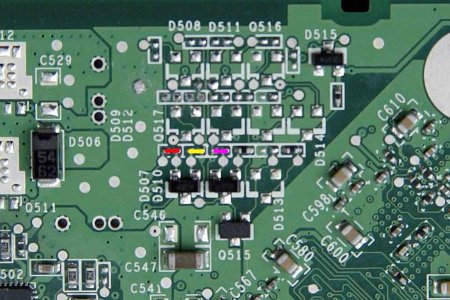

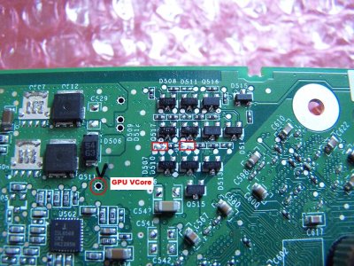

hard modding the GPU core of the 79-- series of cards was very easy to do and just needs a conductive pen (i did a 7900GT and a 7950GT)
attached is a pic of the mod on my 7950GT
my card isn't a brilliant overclocker, but with a little extra voltage, runs quite well
with this small mod, i now get 1.558V for GPUVcore (measured with multimeter at point shown)

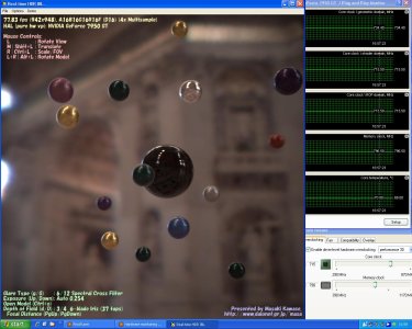

the gpu core will now clock to over 710MHz without artefacts and loads at around 70C using a zalman vf900
(pretty sure it might go a little higher with better cooling)

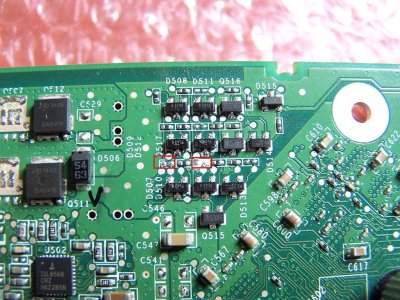

[edit] or in the third pic i have removed the conductive ink from the set of pads on the left (+0.05V), leaving me with 1.507V for VGPU which gets me to around 696MHz for core clock and a 66C load temp

Im totaly lost here cause idk where id even begin to test. So let me get this straight, all i gotta do is use a conductive pencil and put some where you did? On those 2 spots? Or is there more to it?
to check the voltage i just measure between pci-e ground and the spot i marked in the first pic above.
http://www.techpowerup.com/articles/116/images/pcie.jpg
if you're going to be adding more voltage, be careful and keep an eye on temps, but basically, yeah, i put a drop of conductive ink on those spots and it increases the voltage to the core
i originally found the mod on Xtremesystems, there's a load more info on there
red=+0.05V, yellow=+0.1V and purple is +0.2V
i would try just connecting one set of points at first and see if/how it makes any improvements on clock speeds
good luck and be careful to just connect those dots and nowhere else :nono: :D
(and don't blame me if things go badly :p )

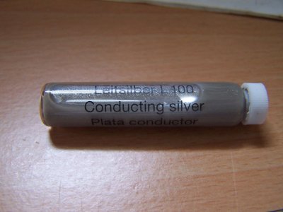

this is the paint/ink i'm using:

Ok ill get that top one and play with it. I have Rviatuner already. I use it to monitor as well. My dad said he dosent have any sliver conducter cause its pretty exspensive. Can i use anything else on it?
not too sure to be honest
i guess if you used a heavy enough pencil (2B? 4B?) and made sure there was continuity between the points with a multimeter it *might* work, but you would need something to seal and stop the graphite from moving or blowing/falling off
i bought that little bottle/vile for about £5 but i have to use a sharpened matchstick or toothpick to dip n draw.
it was marketed to be used to repair the heater traces in car windows, not sure if that might help
- try a car parts store or something maybe <shrug>
