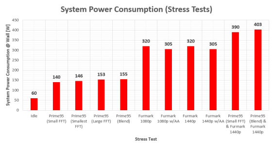

My desktop has a 3700X & a Sapphire 5700 XT Pulse which I'm running off a 450W SFX Corsair PSU. Sapphire actually has a 600W PSU requirement up on their website.
https://www.sapphiretech.com/en/consumer/pulse-radeon-rx-5700-xt-8g-gddr6
I did some tests on the power draw from the wall just to see where I'm sitting.
The power measurement shown is from the wall, so you would have to factor in the efficiency aswell. Despite being way under the 600W requirement on Sapphire's website. I'm still nowhere near the limit of what the PSU is rated to supply.
Actually given my numbers a good quality 350W PSU might actually work too. ^_^
Here are the numbers, might be of interest to some - see below:
That should all be good even at peak load, with a 65W TDP(~90W peak draw at stock) processor with a 225W TDP(~260W peak draw) GPU, you wouldn't expect much more than 400W full system load unless with a watercooling setup or something, they do overestimate what's needed on the box for the GPU's PSU recommendations to be safe though as ofc they don't know the whole system (CPU in particular, a 9900K could be +100W's for instance) consumption or quality of the PSU.
With the efficiency of the unit, there's about 100 - 150W of room to the max output the PSU is rated for based on my numbers above. So there's even room for some overclocks, probably not balls to the wall stuff on the CPU & GPU at the same time though.
