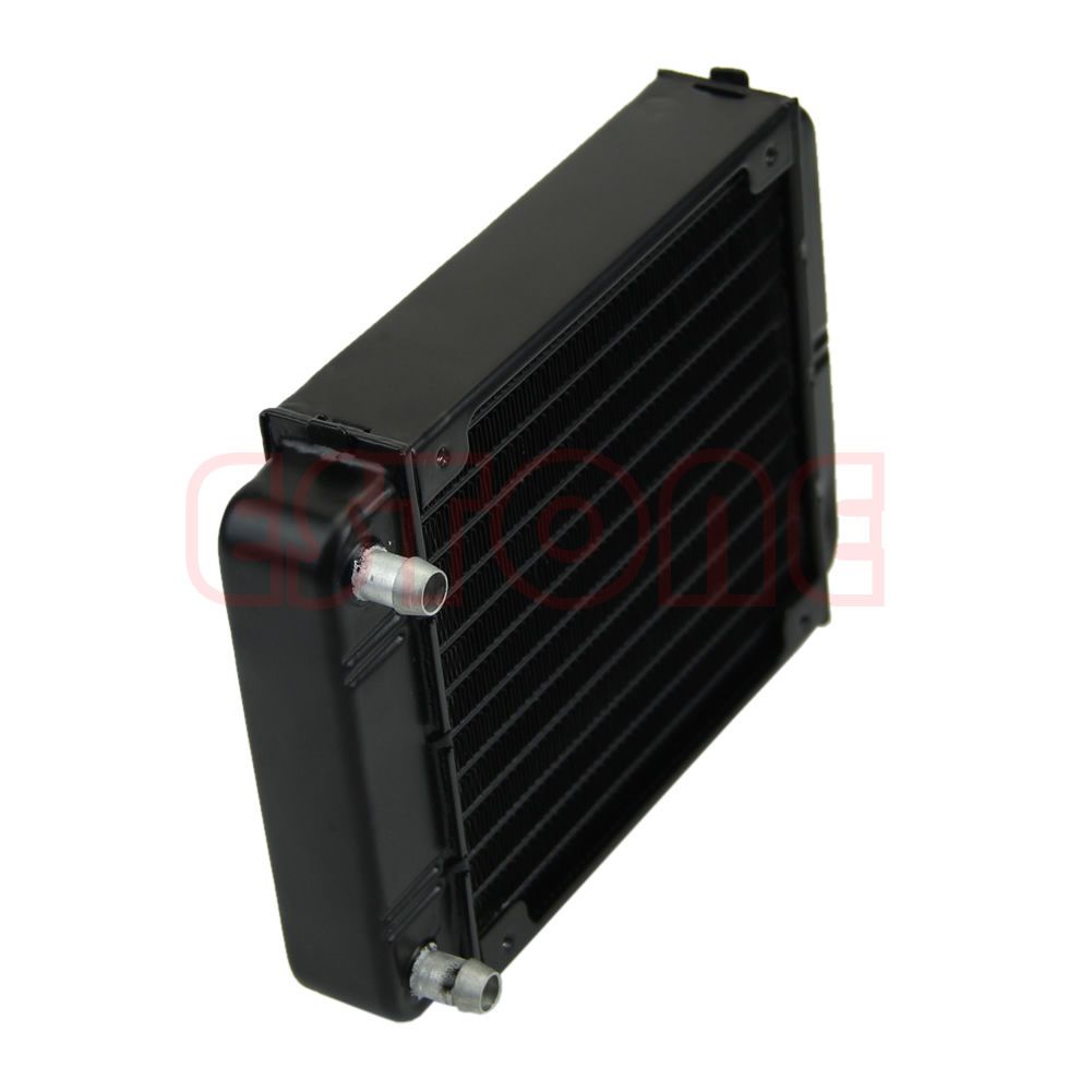

Which has got the gears in my brain moving. Recently on another forum I saw a guy build a loop for 30 Euro and it dropped his temps by 30c (I5 Lynnfield). He used a 240 rad. I can not use a 240, so I am going to get two 120s here for £8 each.

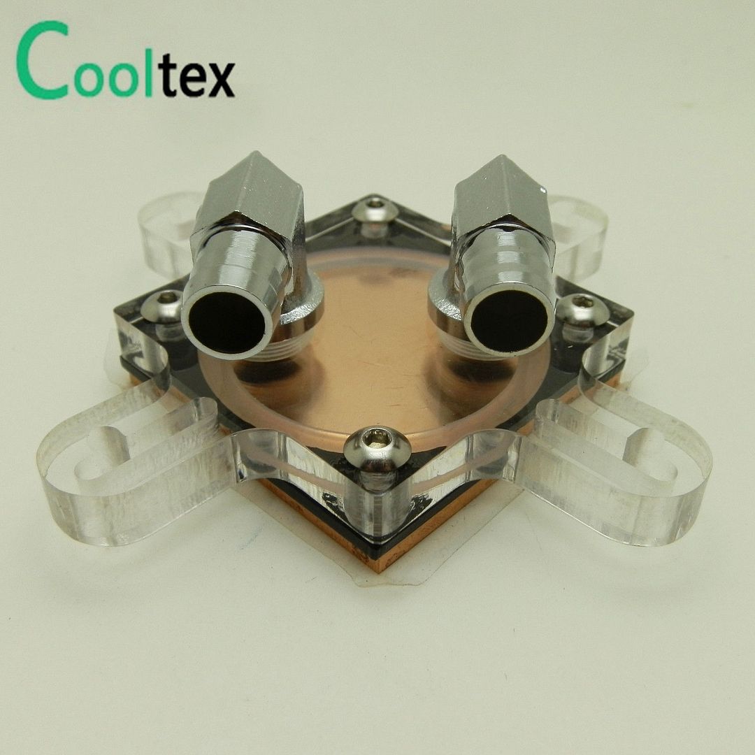

CPU block £10.
GPU block £14

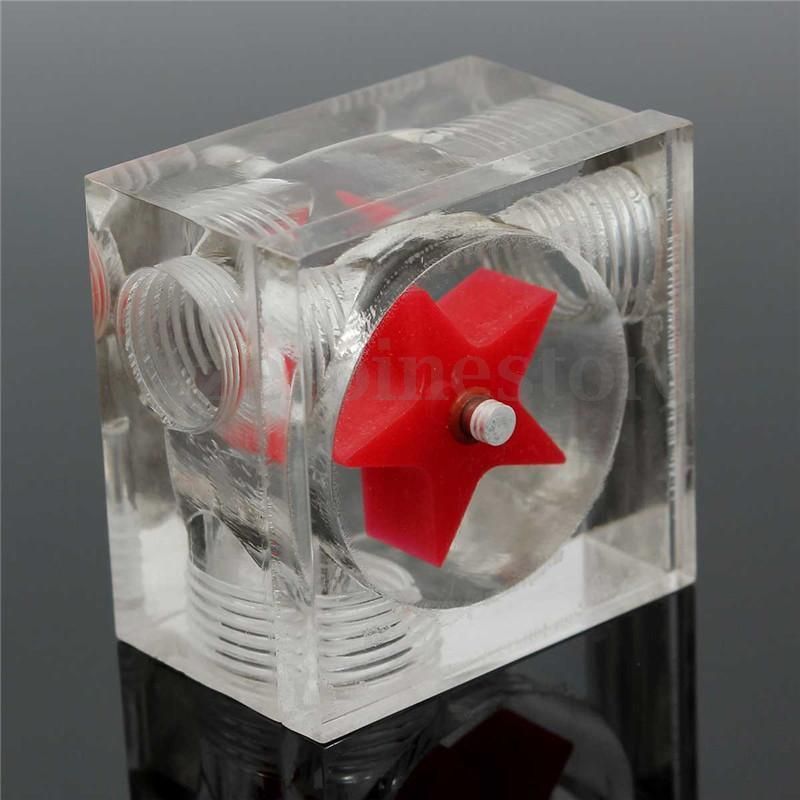

Now for a pump the guy used one of these, they're £3 each.

You dont need to break the rads btw, you can go rad rad

as for the pump placement, i think ideally I'd put them in series next to each other, and not break them apart on either side of something else.. if that's impossible, then fair enough, but my experience with dual pumps worked best when you put them literally next to each other. Also depending on the pump type having 2 can be an issue one can choke / drown the other causing problems. But if like a D5 they are kind of pass-through regardless it should be fine.

OK well that's even better SuB tbh. I can make a nice plate for them to sit on :) good thing is as they are submerisble I can test them in the bath first lol.
Awesomes :) at 3 quid, I'd buy a few spares, I don't imagine they will have the running reliability of more expensive units, but when you have series them up at 3 quid a pop, who cares lol

those rads will be a liabilaty.. get 2nd hand if you must but not those.. as for tubes, if your going barbed 10mm od barb, id go 9mm id tubing thick wall if possible.
but those rads will not have uniformed barbs, and will leak. i have some some where didnt even make it in a rig

Yes that is why you use 8mm tubing and soak the ends in hot water before putting them on.
