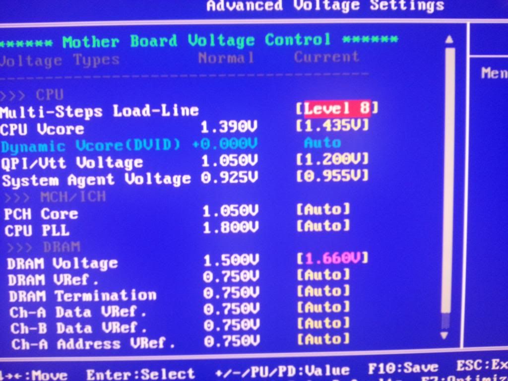

2600k help please @4.7 atm
allen

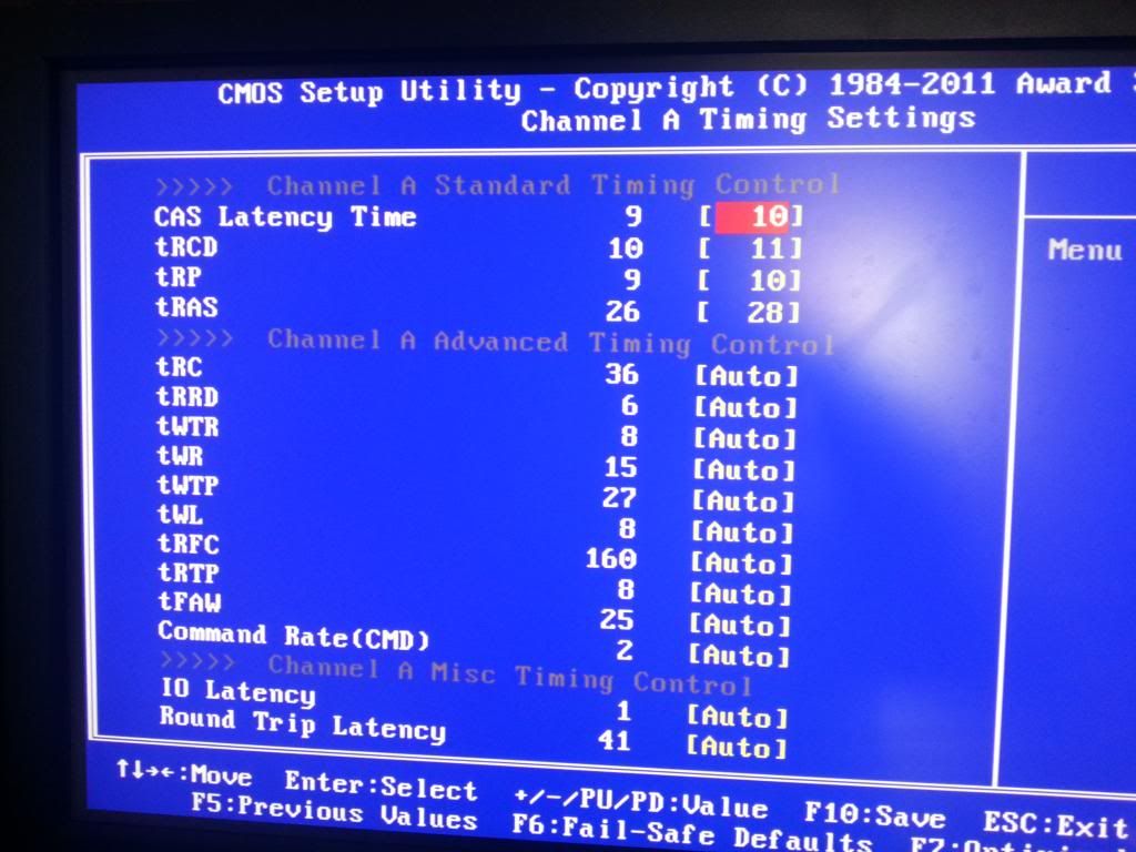

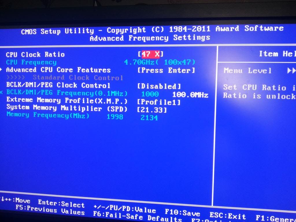

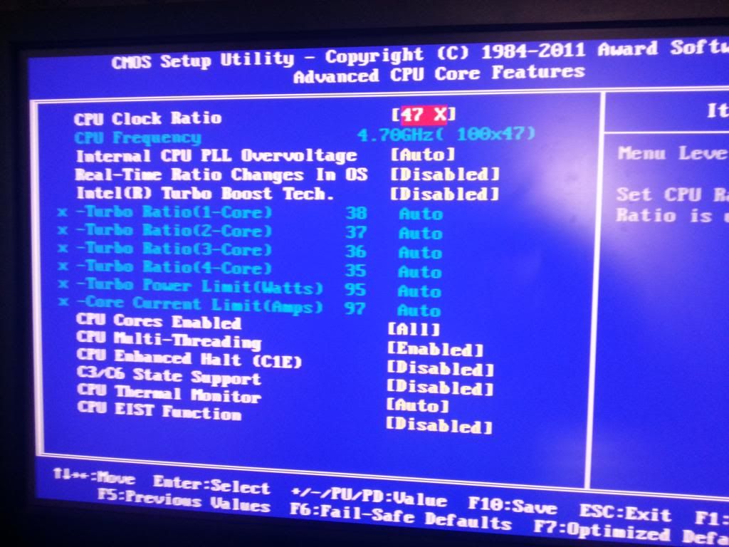

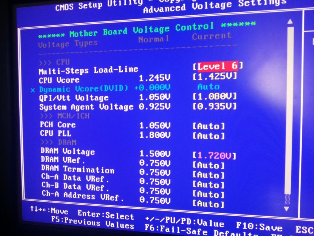

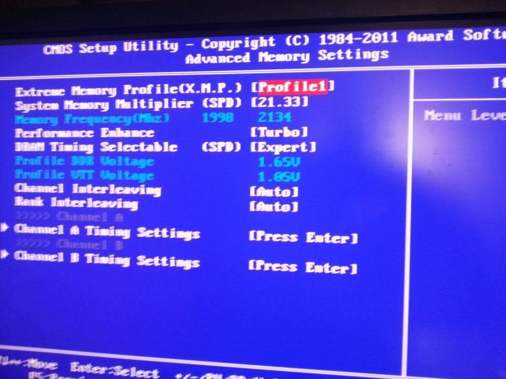

Hey any help here would be great, Iam not sure how many volts i can go up to to get this any higher than it is ? aswell as getting the ram to run @2133mhz, so anyhelp with settings and ram timings would be great :D
here are the bios pics its on a Gigabyte UD5 z68 rev3 board, the ram is G.Skill Ripjaws Z 2133Mhz
Thanks in advance :)
Performance enhance diasabled.
QPI volts need to go up. 1.1 - 1.2 ish
you shouldnt need more vcore you just need to set the rest up properly
BTW ram volts 1.65 max. what youre running is fucking stoooopid!
ok so i have messed about a bit changed ram volts but to get my cpu to work :@ 4.8 vcore has to go up more than this as this isnt stable
ram volts only go 1.64 or 1.66
ive also change the ram timings as the were wrong aswell :S 9-11-10-28 they were on 10-11-10-28
whats load line calibration what should that be on ?
also temps went up 10c on these settings aswell ?
I am brand new to oc'ing but from what i've seen it looks like 1.3~ is the upper limit people use on the intel cpu's and when someone goes higher than that, it's a ''big deal'' and not in a good way, i've also read that sandy and ivy both like their ram either 1.5 or less. Also, no idea what "CPU PLL" is but 1.8 seems... high..but that's apparently on 'auto' ?
