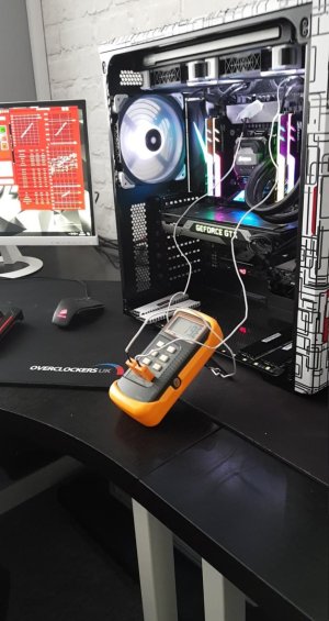

Hate to say this boys but in my testing Ive had 0 throttling or hot mosftet heatsink issues.
Im actually runninng some tests with a thermometer now and not getting anything like whats reported in this video.
Also if you look in the comments JonnyGuru explains what his PSU cable issue is (and its the PSU cable connector)
Ill look into this more but I have a strange feeling something else isnt right.
If you think about the size of a Z270 heatsink and the fact they have more phases wrapping around the CPU the limited real estate the X99 & X299 boards have for power and cooling is limited. This IS also made worse by the fact SL-X also pulled more power but Ive seen nothing above what the heatsinks could cope with.
My front heatsink is 40c and the rear one is currently 52 - MUCH different to whats being seen in this video (7900x - 1.235v - 4.6GHz)

I would have liked to see how he actually tested them in the video, as in was there any airflow from fans over the heatsinks, was they installed in a case or just on a test bench and so on.
I am not going to call straight up BS but it does seem rather odd that he is saying to wait for Asus to release the "High End boards" or pay for watercooling for the boards, when as Tom has said he didn't experience any issues and I have not seen anyone else saying they experienced any issues.
