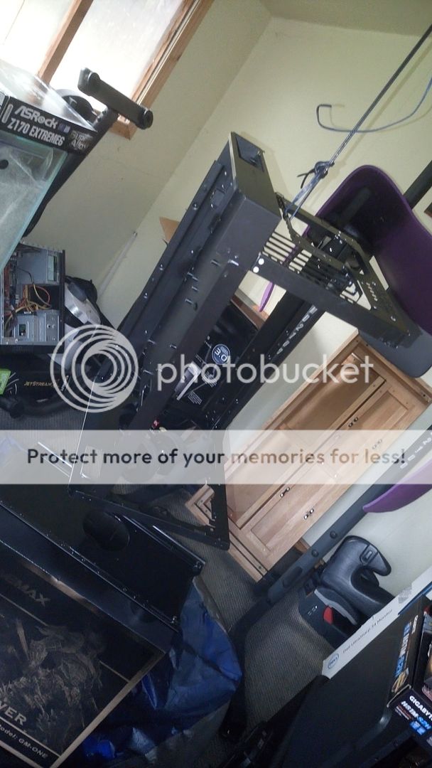

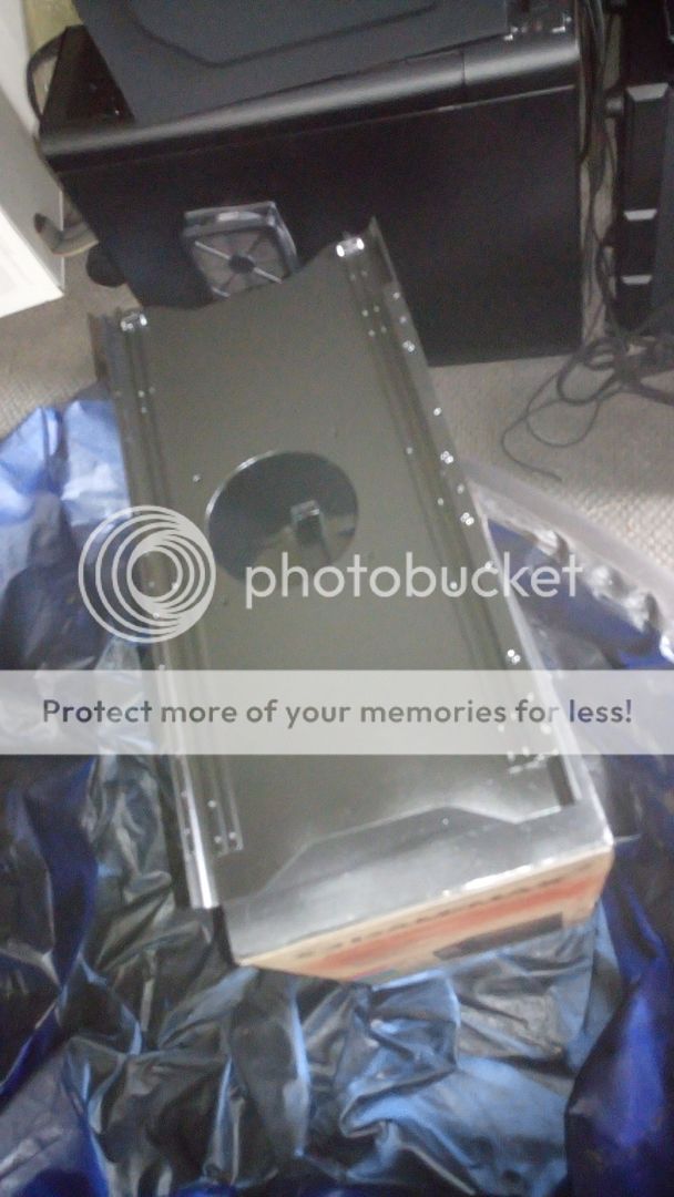

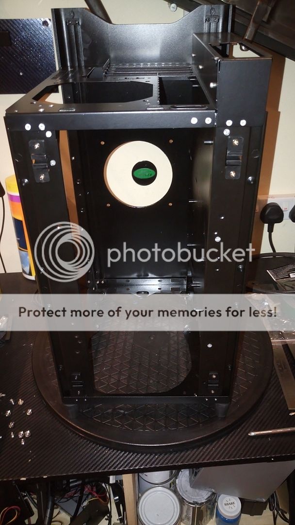

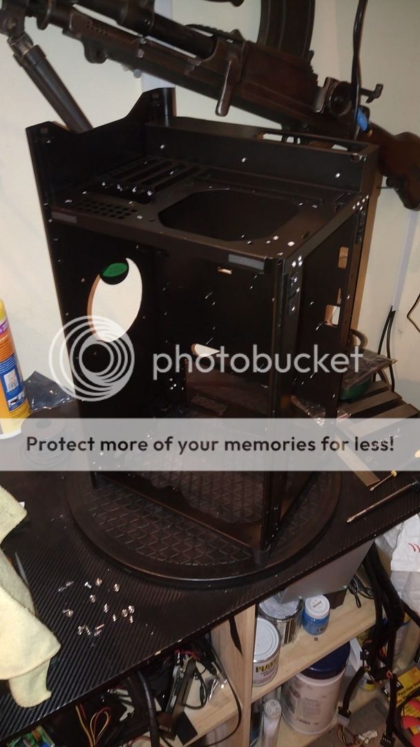

I have completely removed the original PSU bottom bracket and modded the bottom panel to fit the 180mm AP fan and rad. This also involved removing some of the Mobo tray. Here is the stripped down and modded skeleton on the spray rack.

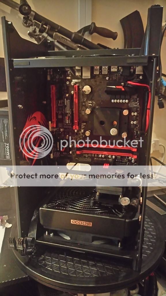

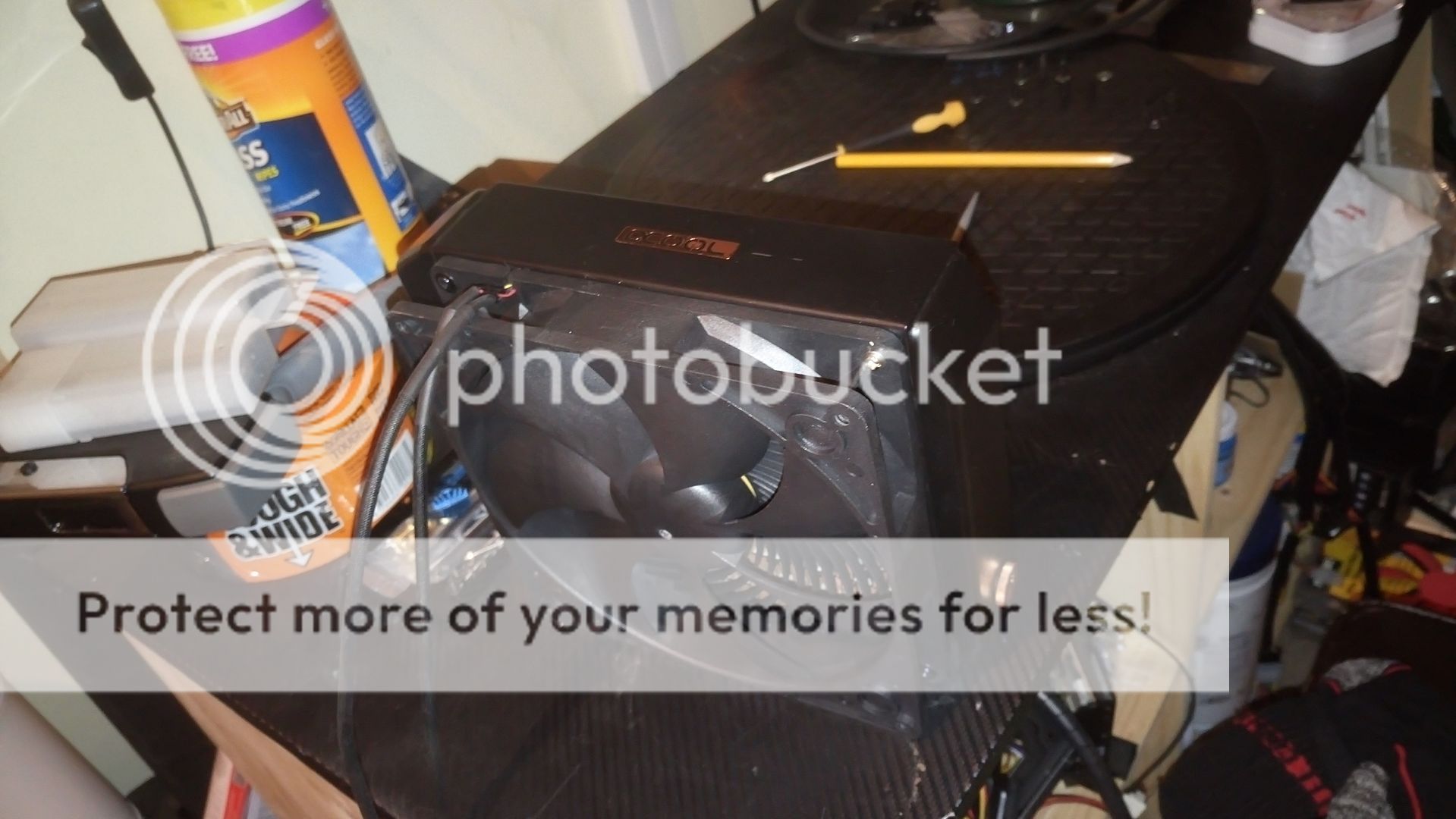

OK. putting it back together, ...Gives a better impression of the metal ive had to cut away from bottom panel and mobo panel..

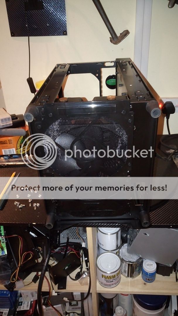

Here you can see view from bottom with 180mm AP fan fitted...
You can see that I'm able to utilize the original bottom fan filter(magnetic)...

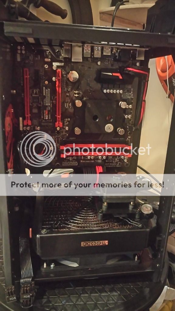

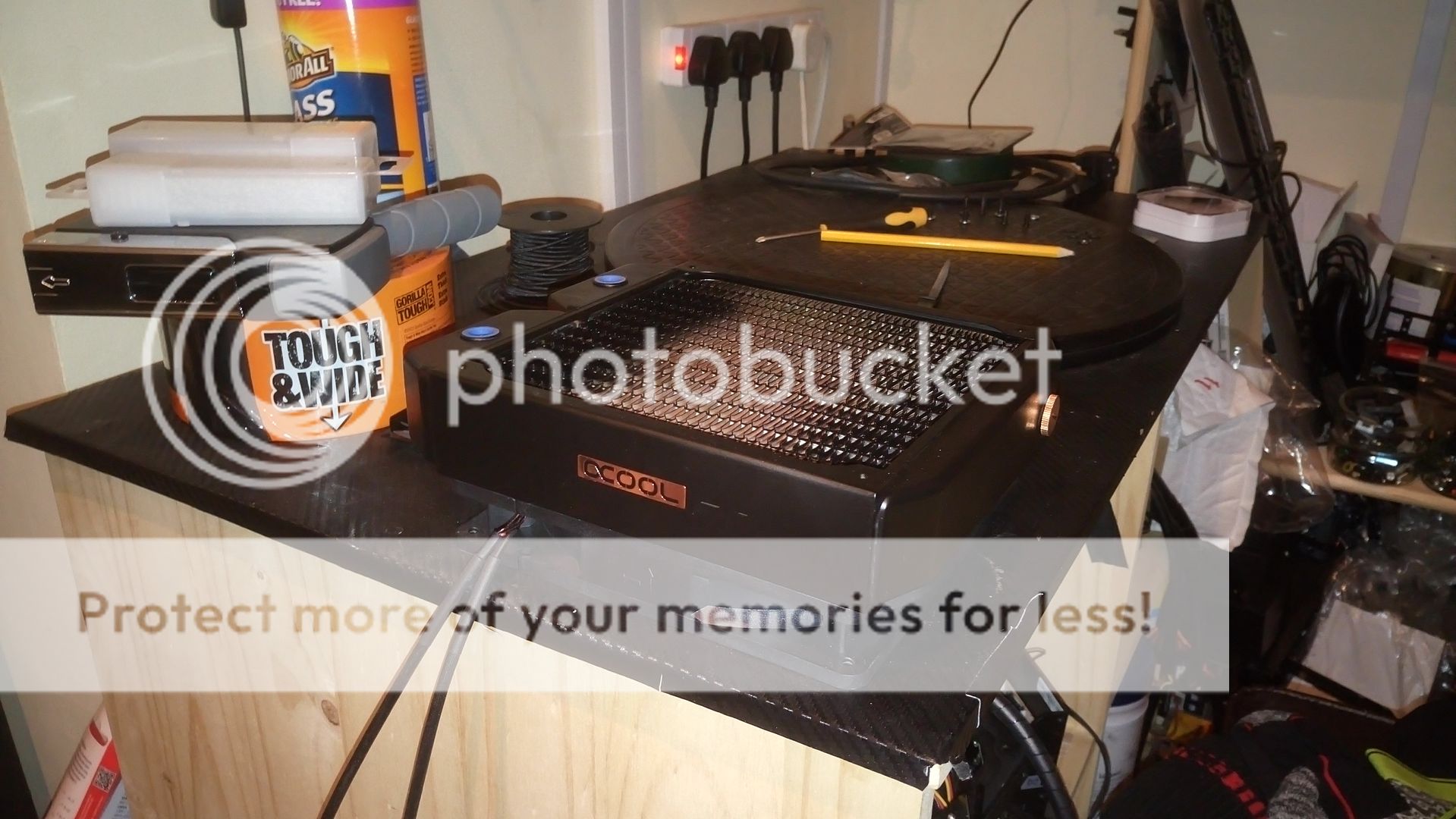

And from top with Rad fitted....

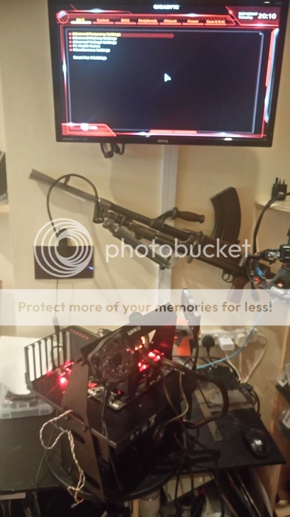

Here testing getting ready to install Windows 10 64bit on M.2

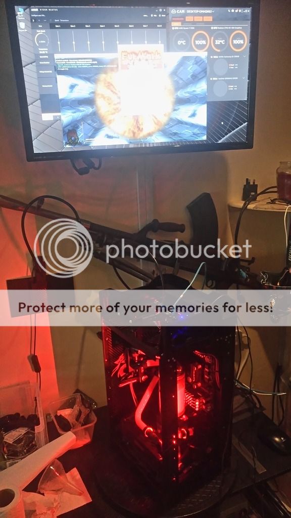

Filling, Leak testing and Bleeding.....

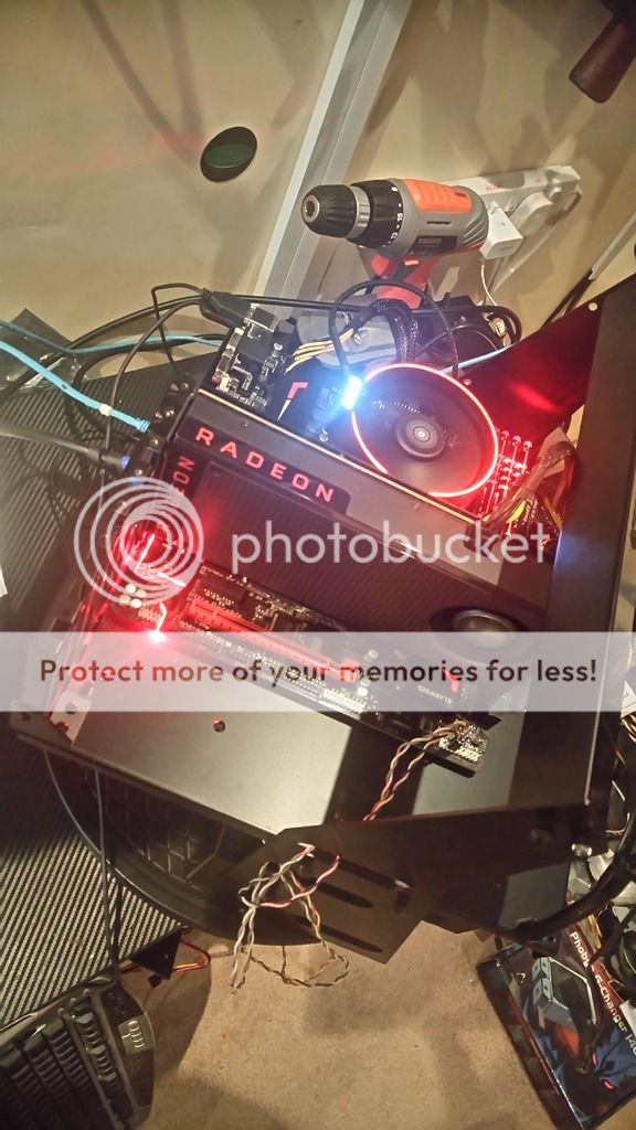

First boot...

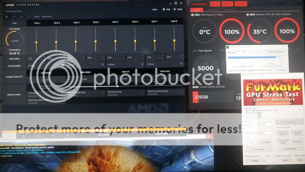

Temp and Stress testing... you can see temp results for yourself 180mm AP FAN is @ 775rpm
BIOS settings all on Auto getting base of 3.2ghz on all cores when stressing and 3.8ghz on single core....Memory running at 2133 hopefully BIOS update will allow it to run at default XMP3100 but it wont boot with XMP on at the moment.
