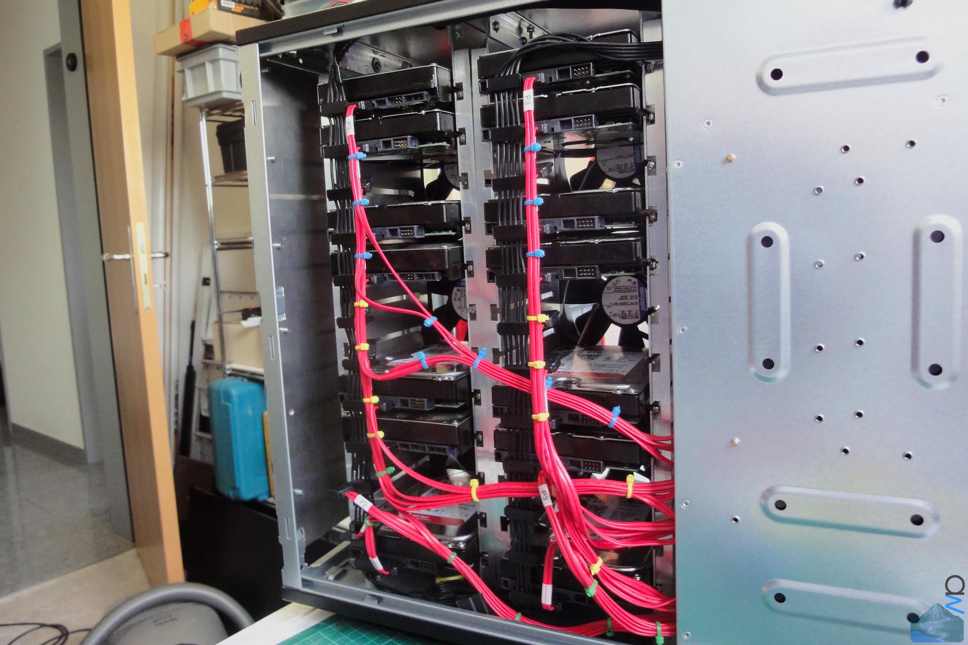

That's what I've been thinking TBH. It would be totally awesome to make this all pretty
and such, but as things are now I can neither justify the costs to my dad (who would be
paying for it) nor do I have the time, with time being the bigger problem (I might be able
to get the cash to pay for powder coating myself). But hey, maybe at a later date?
Despite that, there will definitely be custom cables. If I can't have pretty colours I at
least want things to be anally tidy and neat.
