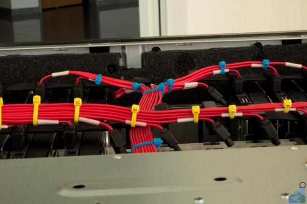

Needed to hook up some HDDs to test the LSI controller. Looks very ghetto, worked
like a charm.
(click image for full res)

now thats a tight fit
look right though
just one comment can you change the yellow tape to red to match the sata cables
Hm, I don't think I have red tape lying around.

Wow, great job on those disk racks!! Great work! Are you doing custom power/SATA cabling on the hard drives?

Thanks, I'm very happy with how it turned out.
Well, custom cabling is a bit of an overstatement. The PSU comes with two
cables that are long enough to serve one disk tower each, so I'll just be running
those down each disk stack and put more SATA connectors on them. It'll
be nice and tidy.
The SATA cables I'll leave as they are, I'll just try to get them as tidy as I can,
but I won't be sleeving them since it doesn't really make sense to spend the
money and time on it in this build.
So: Tidiness: Yes. Colour coordination: No.

Yummy, perfect SATA spacing, for once. I never understood why power supply manufactures always left so much bloody space between SATA connectors! HDD cages have been pretty much standard for spacing since the dawn of time.
