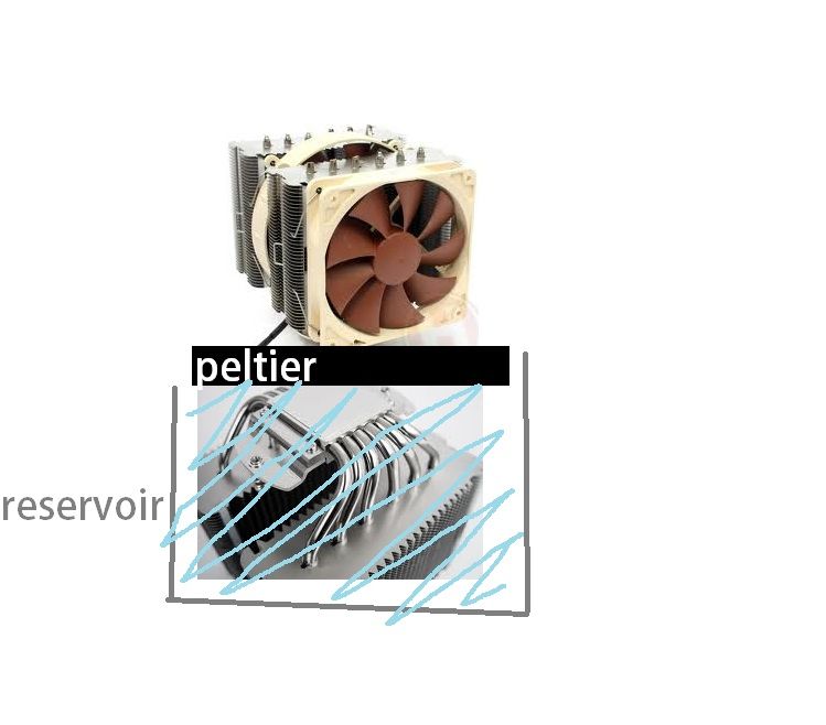

I most definitively want to see a project log about this. Have you thought any more about what material to use when guiding the flow/loop around? I'm quite curious.

Sounds like an interesting project
I've been looking at simple chillers with a friend for a build he's considering. We'd thought about still using conventional rads in the loop to get temps post-block back to as near-ambient as his current loop is able, before further cooling the fluid via the chiller. The chiller would of course only kick in once a certain coolant temperature is achieved.
The ideal situation of course would be to have the chiller do ALL the cooling work, but that'd see the PC likely drawing 2,000w+ from the wall, which is a bit silly lol. Still, I am impressed that the higher-end chillers can provide up to 1,650w of cooling with only a 550w power draw. I think a lower-capacity chiller with a simple rad to take the edge off the temps first would work nicely.
Anyway, great project, keep us posted!
