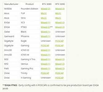

Doesnt EVGA counter this arguement and state they have tested and verified this to be the cause?
I wonder if Gigabyte are defending themselves because we see what components they are using
I found this list so am curious how well it correlates to those with issues.
source from EVGA Jacob incase others want to click on the links within the table.
https://new.reddit.com/r/nvidia/comm...eb2x&context=3

It could be the cause(Or a major aggravating factor) for EVGA and not the cause for Gigabyte, depends on the rest of their power circuitry, also depends on which type of tantalum caps they selected ofc, Gigabyte confirm here they have some pretty high end caps, and well selected for high frequency filtering

It is worth noting that there are multiple ways to fix some problems. EVGA wanted to address the problem without Nvidia drivers and changed components to do that.
This isn't a matter of MLCCs are better. We do not know what caps EVGA were using, and we, therefore, cannot discuss their quality.
They changed to something better, but that doesn't mean that a fix couldn't have been implemented with better SP-CAPs. It's a very complicated issue.
I'm no expert, but the situation is not just about MLCCs vs CP-CAPs. A lot of the blame here lies with Nvidia and their early drivers.

EVGA originally used 6x220uF caps. That's 1320uF compared to GB's 2820uF. The same MLCC caps are 47uF so a bank of those is 470uF. Yes having some MLCC is better to improve transient response as they react more quickly but 6x470uF is still pretty good.
Check out Debauers latest video, on the GB card he swapped 2 of them out for MLCC banks and it allowed him to get another 30MHz overclock.
