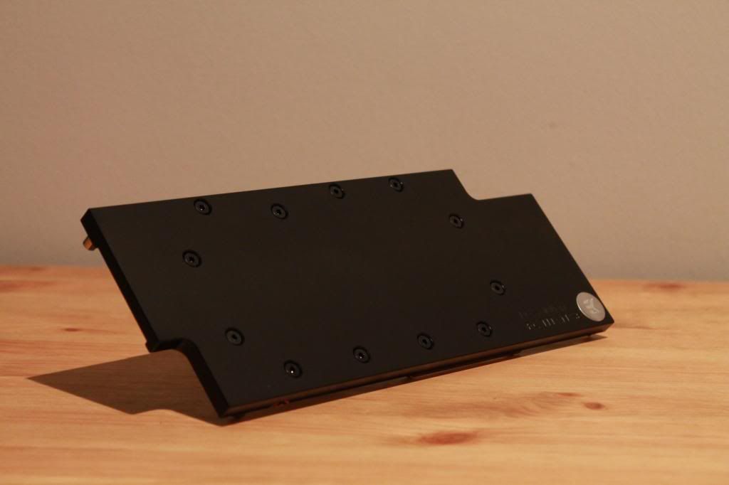

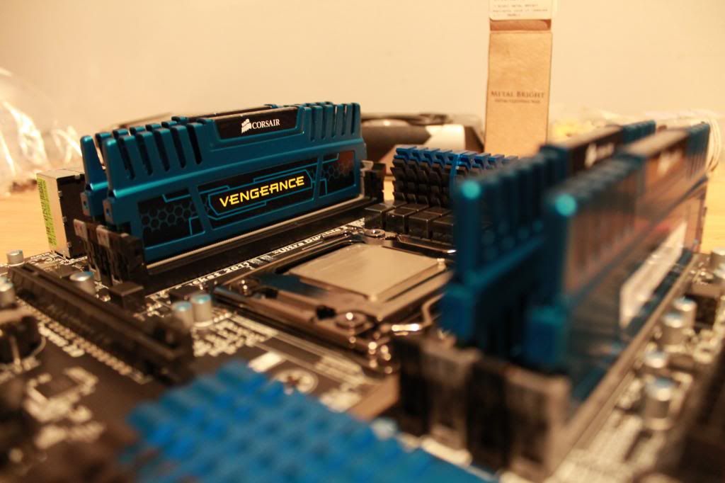

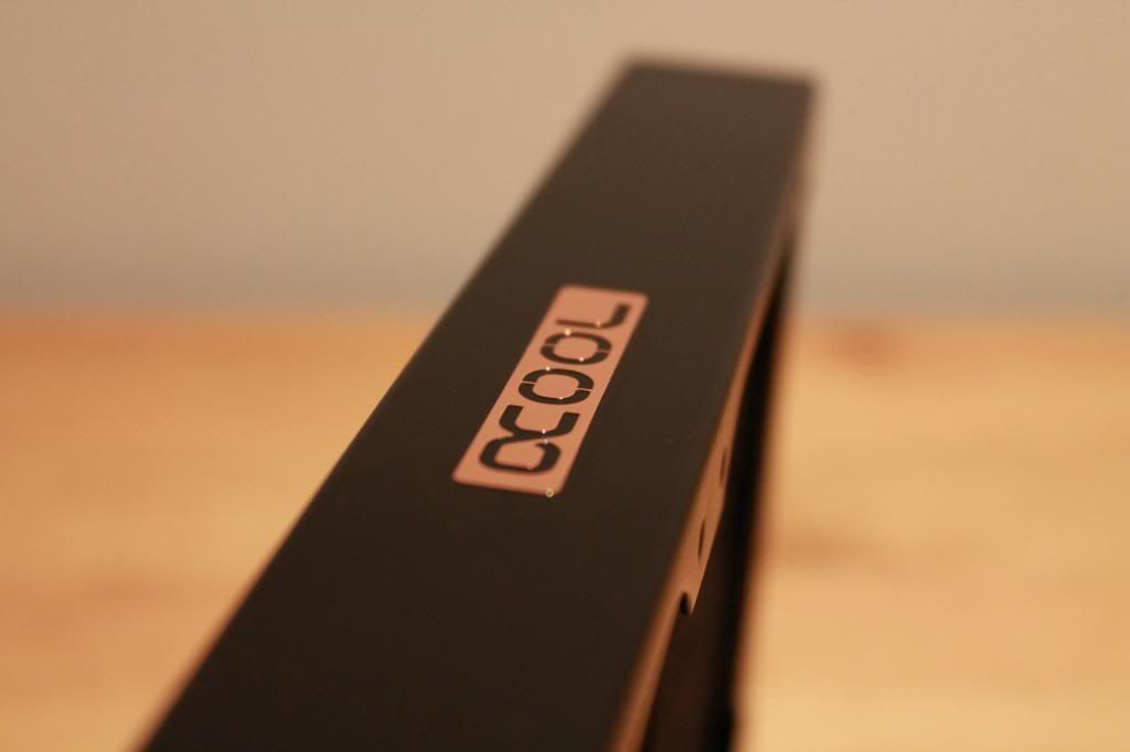

Managed to get in and take a look at some of the parts last night/earlier today! Just taken delivery of 2 more fans and all the braided cables too.
Only the second Titan block I'm waiting on now then!

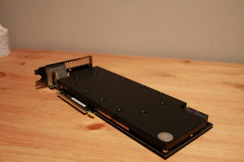

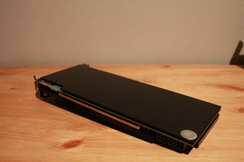

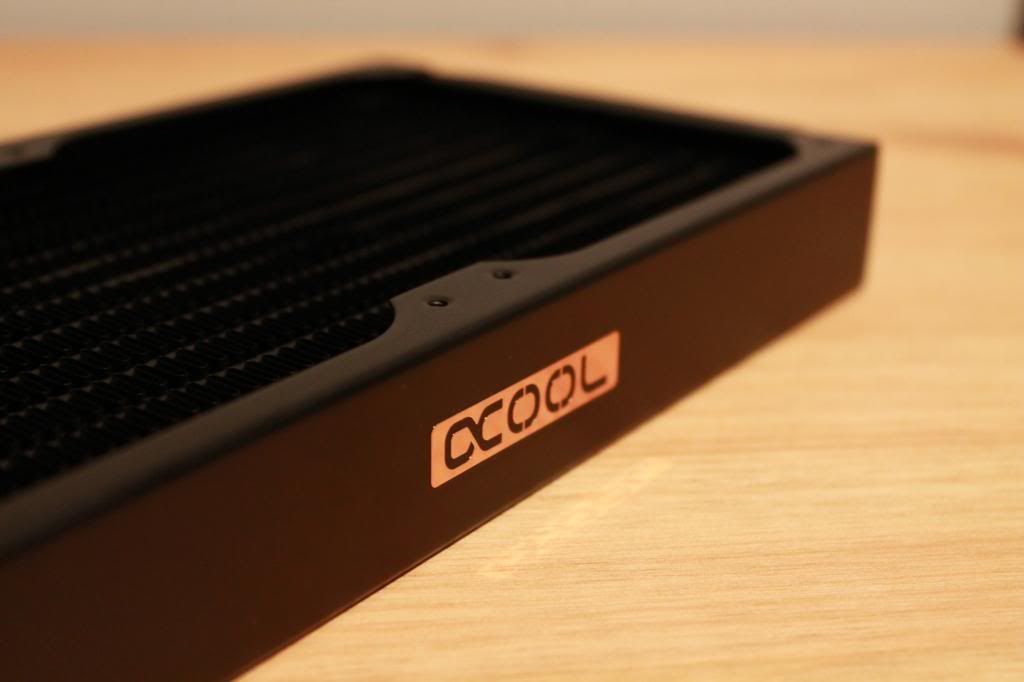

240 Rad

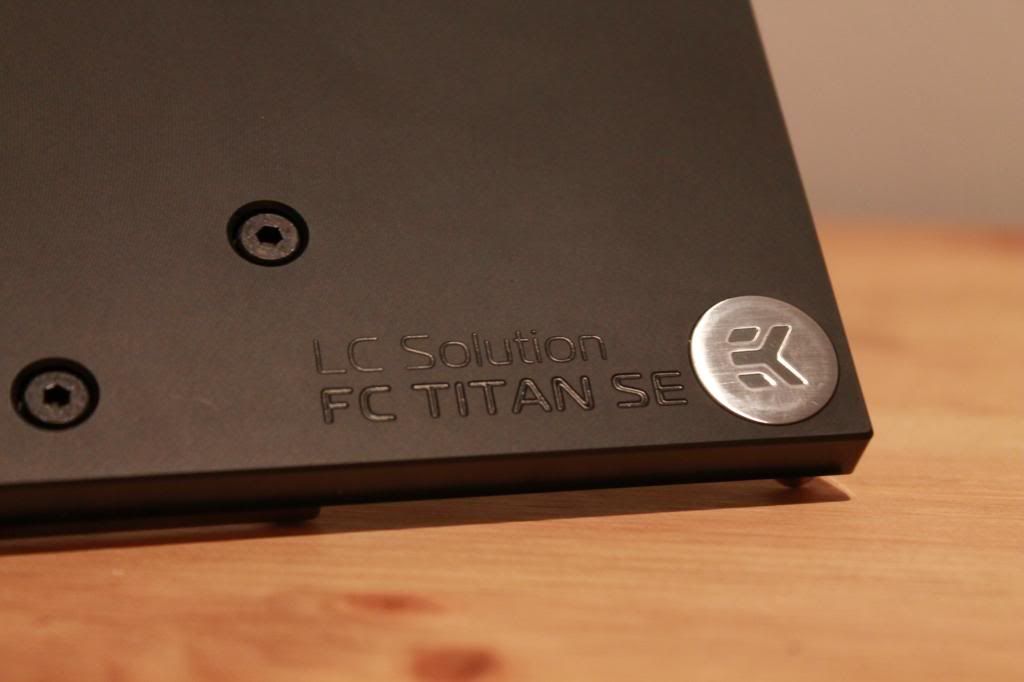

EK Titan Block
SP120s (2 more coming)

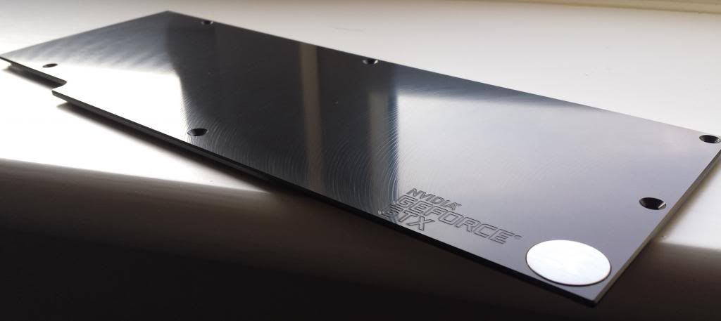

EK Backplate
I've done a little testing with the current setup, the fans are sounding good to me running at 7v, but even at 12v they are so much quieter than other fans I've had before.
I gotta say, the more EK gear i see the more I'm starting to dislike their branding again :( big silver brandy circles on black.. it's almost as bad as that blocky acrylics/mylar with circled etched into it again :( bit too ostentatious to me
I preferred them when they were just straight-up plain shiny not frosted blocks.
But that's just me, I think (ninja edit: Bitspower) are taking over that department, their last few blocks have been flippin gorgeous.
Are they a new gambling organisation? :P
I really like the quality of the EK stuff, the cooling is very good, there are only a few that cool better I think, coupled with the backplates I should see some decent temps.
I'm not so fussed on the silver - I would have personally loved it in white and may actually get a friend to make me up some white EK logos to stick over the top of them. But that's just an idea so far.

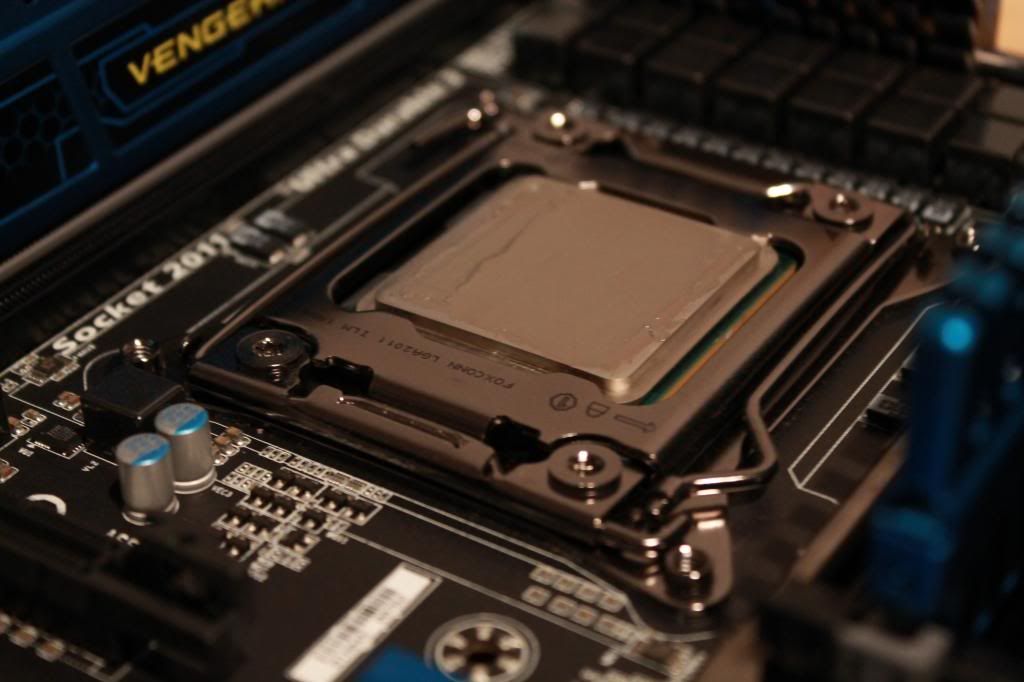

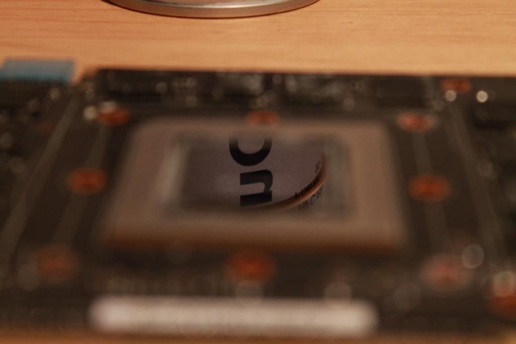

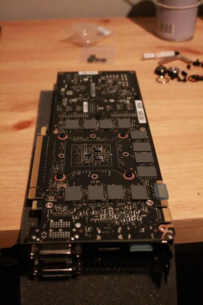

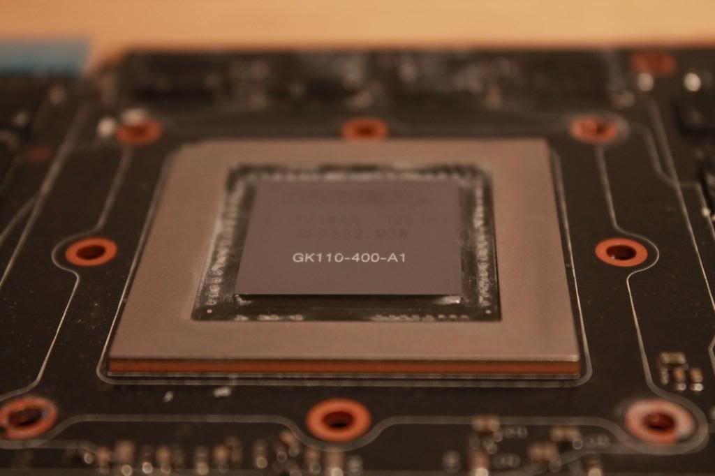

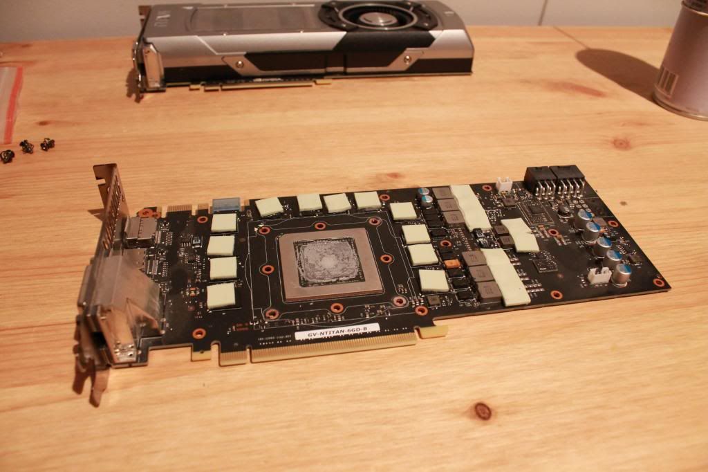

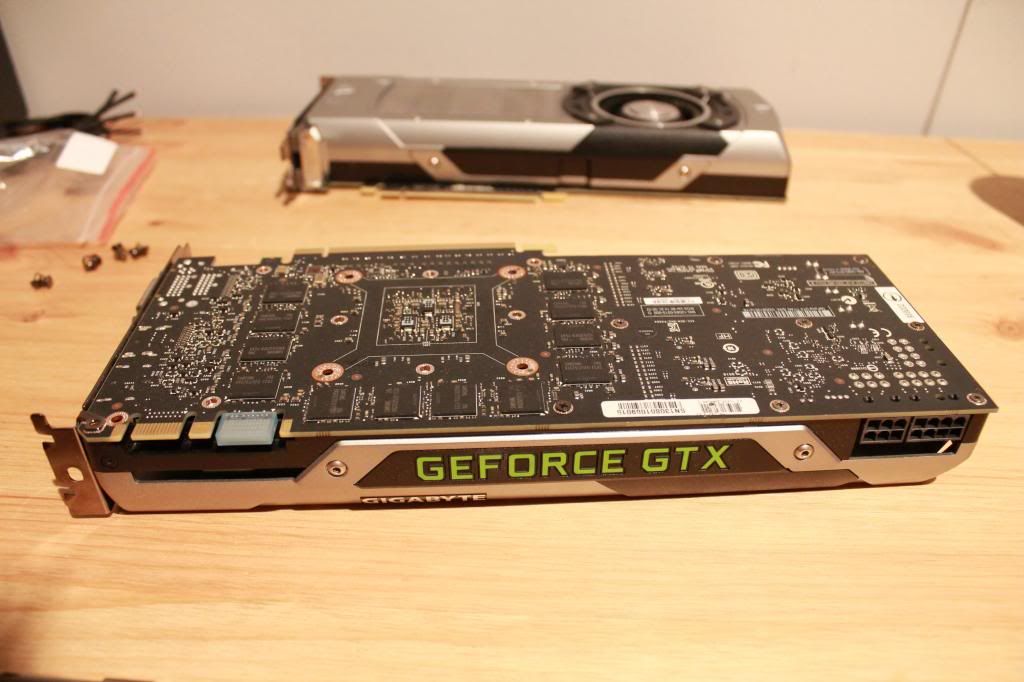

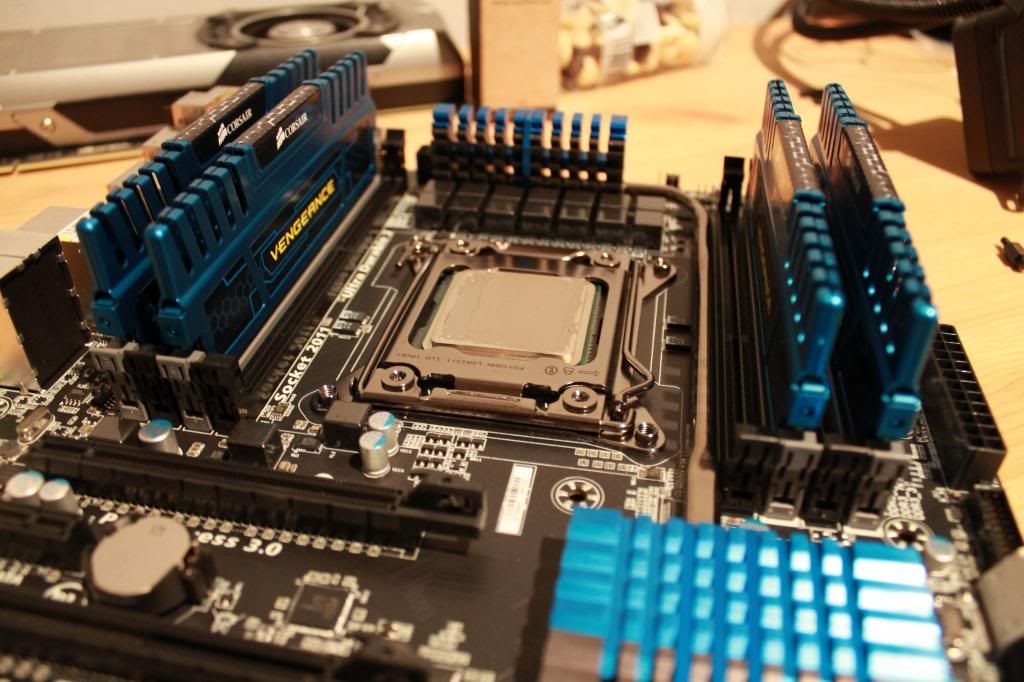

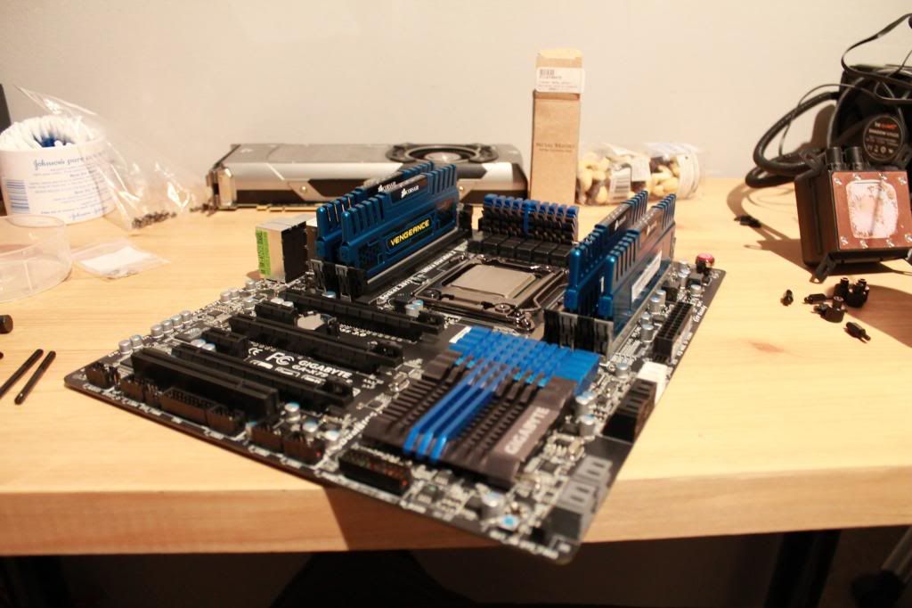

Cracking the Gigabyte Titan out, stock cooler off, thermal pads off, die nicely cleaned (couldn't get some of the old thermal paste off the edges - opted to leave it rather than rub away with cotton buds)!
Most cleaning was with metal bright then alcohol to remove it all.
Then I realised the EK block didn't include any washers!! So at the moment the card is upside down on the waterblock waiting for the nylon washers to arrive! So I moved onto the CPU...

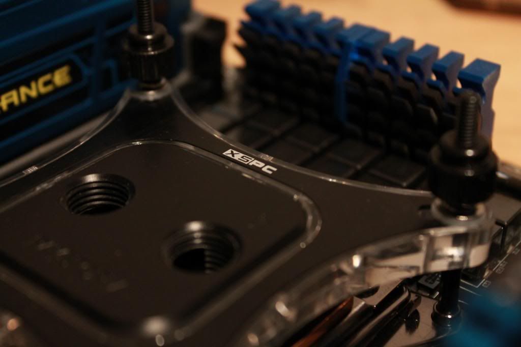

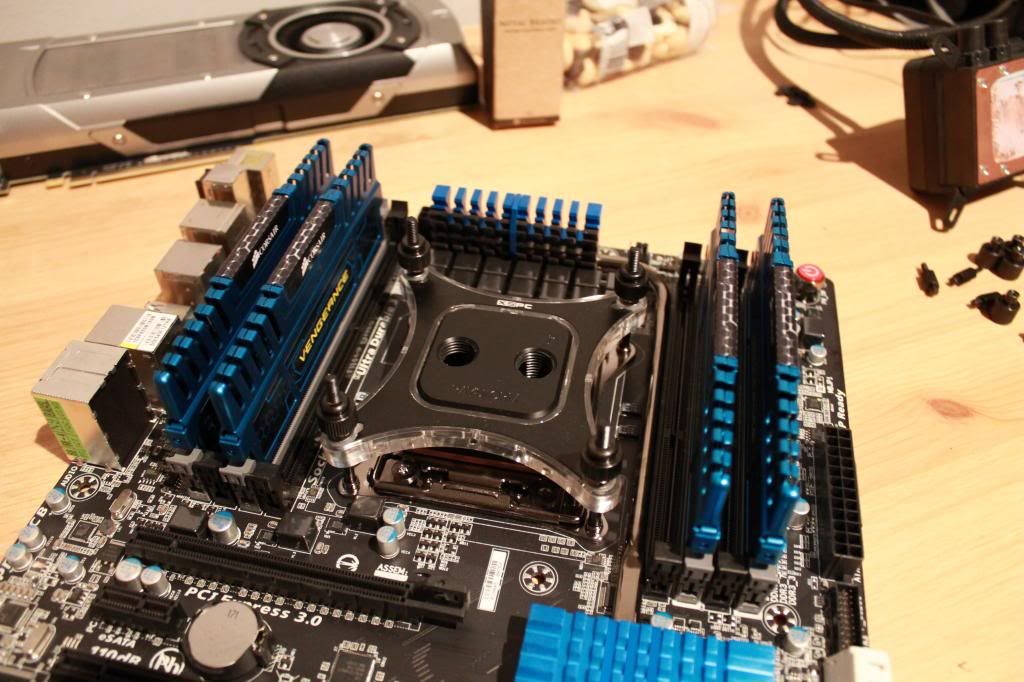

H100 off, CPU cleaned up and in the middle of spreading the TIM, then with the Raystorm on with fittings & LEDs

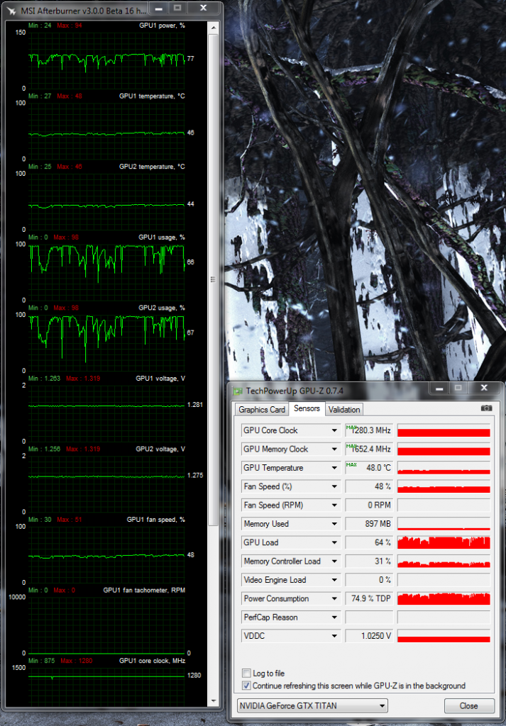

So they will happily run stable at 1280Mhz Core (876Mhz standard boost clocks) and 1682Mhz (1502Mhz standard) Memory with 1.3V running through them, at less than 48 degrees, which isn't so bad considering they hit 72 degrees on air at 1.2V.
That's an increase of 46% on the core and 12% on the memory. Though to be fair I haven't touched the memory much just yet. They should scream along in games and benchmarks now.

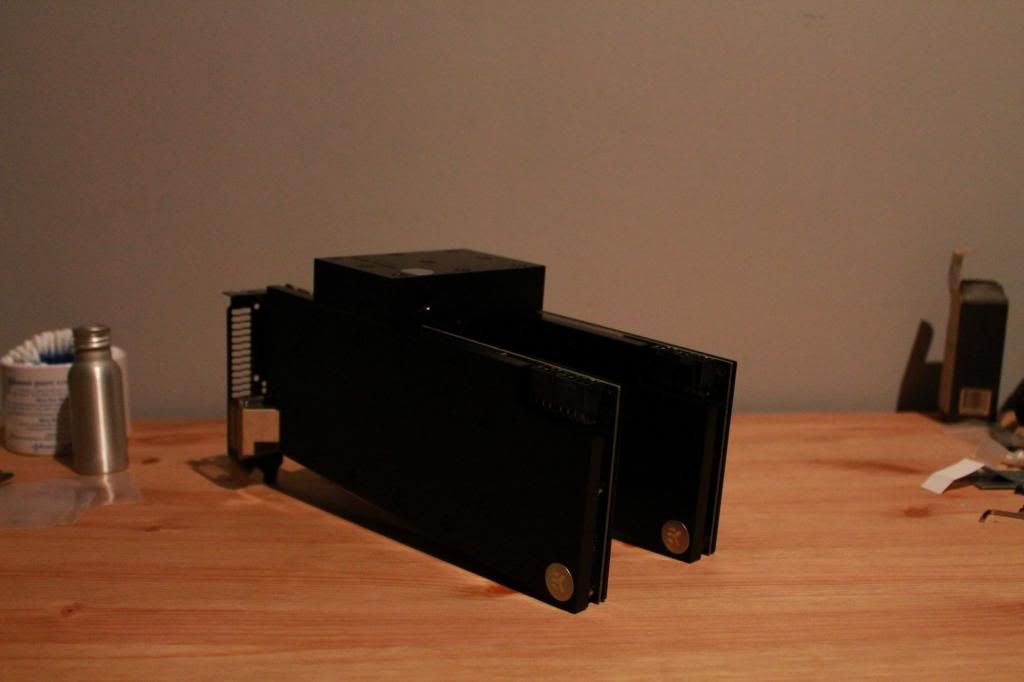

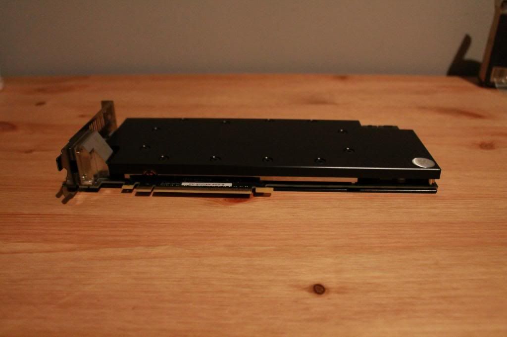

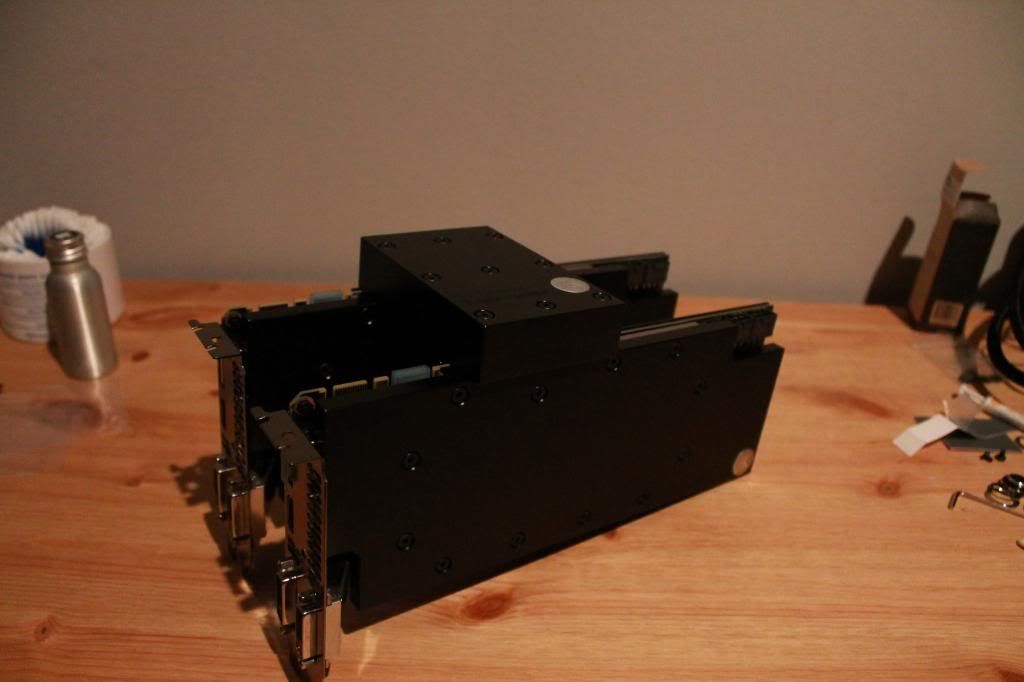

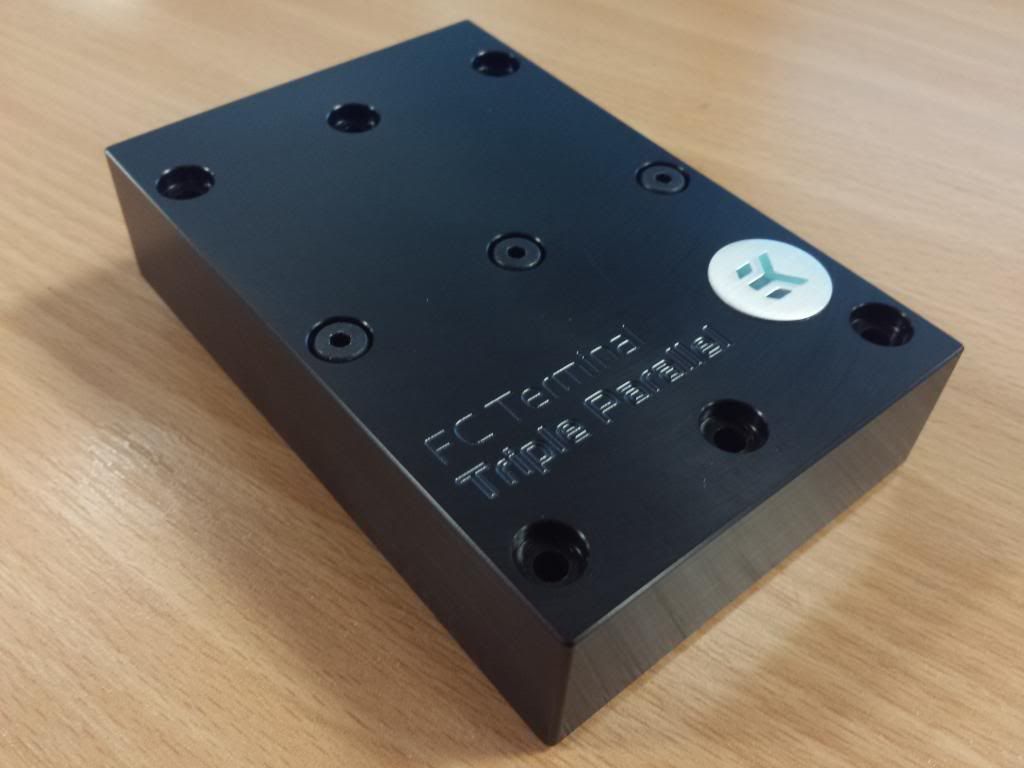

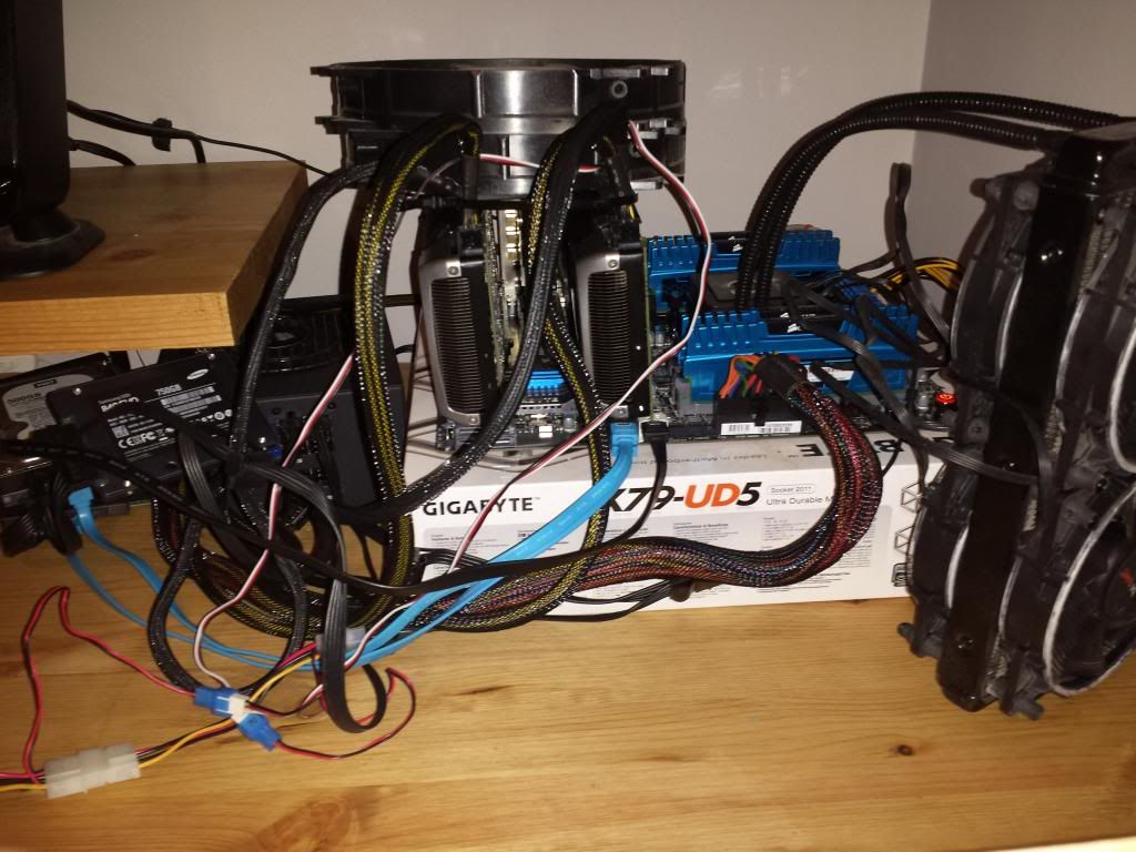

So finally had a chance to sit down and look through it all. Have now received my second EK waterblock as the first leaked from between the acetal and nickel layers, tested it three times (damn are those O rings hard to line up on the terminal connectors), but was still leaking so sent it back.
As promised, a few pics of the 'bench' setup.
Fixing up the blocks:
And backplates!
And some fun hashing power:
The Asus card is 77.2% ASIC quality, the Gigabyte is 72.8%. They are 24/7 stable at 1255Mhz core, 1752Mhz memory, so that's +379 and +250 (+500 in afterburner) accordingly. Running at 1.3V they stay under 60 which is decent as at stock 1.08V they would hit 72 and get quite loud under my fan profile.
Now just waiting for christmas day to put it into the new case!
1.08V is stock (ish), 1.212V is the highest you can go in afterburner and the like.
However if you shut down afterburner you can run a command line prompt and manually edit the profile text files to unlock it to 1.3V, that's where afterburner stops then. However, you can also use another program to push it as far as you want from then on... some people have hit 1500Mhz on titans with fully unlocked voltages.
It of course also needs a custom BIOS to enable the power slider up to a higher value.
