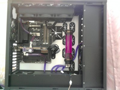

little update been making some noise and mess today
can you tell what it is yet :)
wanted to mount rad without any case cutting if possible
slots over the tabs so no bending or cutting them off and bolt down using HDD screw holes
fits just nice only fitting a 240 rad but cut for 480 hoping to upgrade later
80mm rad in push/pull comes flush with rear of the bay what more can I ask for
before anyone say's thats not the fans I'll be using just setup one's
got top rad fitted 45mm in push/pull and loads of room left
thats today done see what tomorrow bring's
little update not much done today
got fans mounted and all the hole lined up :)
fitted some led strip to MB side of GPU waterblock and started to throw some hose at it to work out what looks right
not sure what to do down here to just stand pump on bottom with res above also thought about boxing it in level with top of PSU to hide pump and cabling what you all think I'm leaning towards boxing in but the bottom fan air flow concern's me

A little more playing today
front of the platform sloped to avoid fan air flow
needs more work yet but I think you get the idea pump to be hidden under this going to wrap it when finished not sure if to go white to match MB tray or black for the contrast any thought welcome
got a bit more done today
PSU boxed in with pump hidden covered the side of the drive bays
and got the wet stuff in and tested please ignore cable hanging out its a test supply for the pump :)

not normaly a lover of chrome but my god that front end looks awesome :)
and loving the work mate, that case really does look empty... a little tip if you can turn the speed down on the bottom fan otherwise you will end up with a large loop of turbulent air, under your GPUs which will hold heat
Nice work, man! That bottom box is looking very sharp :cool:
look awesome dude!!
