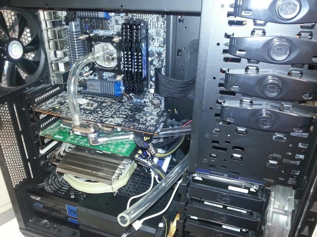

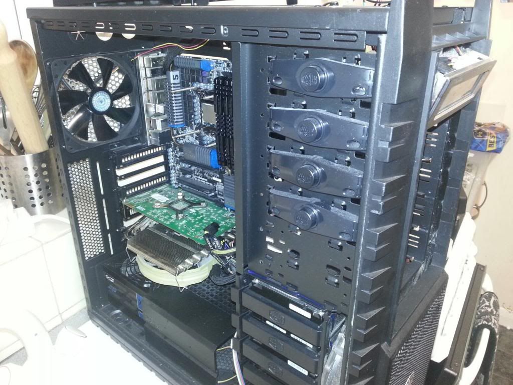

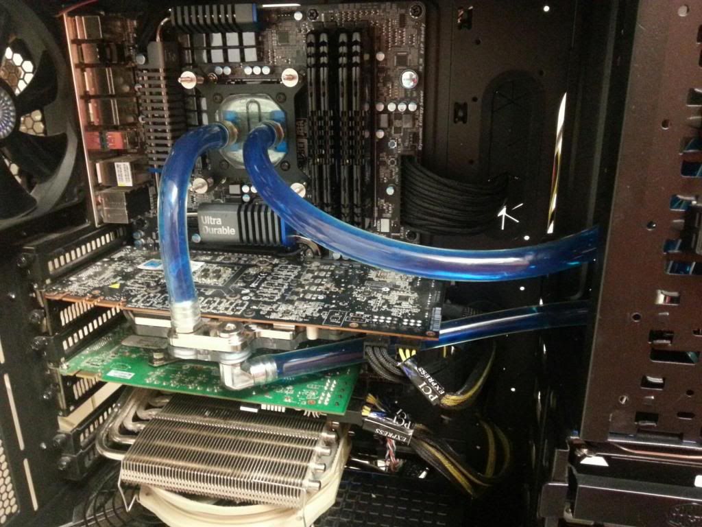

Hey thought id do a post about my rig after it went a bit horrible and my temps went skyhigh..... i had mayhems pastel in for about 6 months probs to long for it to be in anyway, but it started to go really gloooopy and temps went from maxing out in 50's to maxing out in 80's the loop has a 17 2600k @4.7 and a 570 super overclocked in it here are some pic from before..

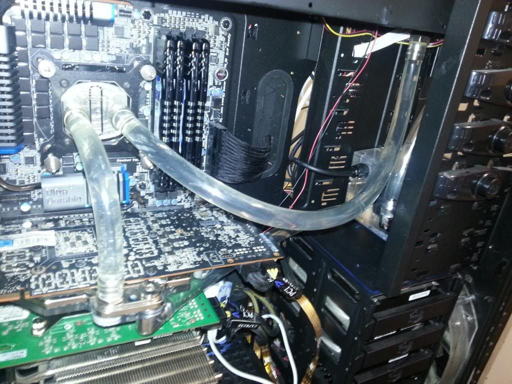

it wasnt looking to healthy anyway and needed a good clean, plus the last loop i did was just with bits of spare tube i had so they are different thicknesses half and 7/16ths...

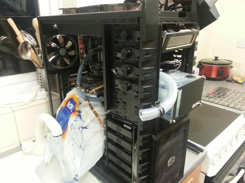

also i used the tried and tested professional anti water getting into your system majig or in layman's terms an aldi carrier bag

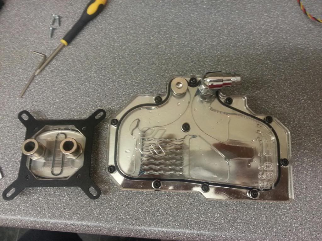

Cleaning out was quite easy

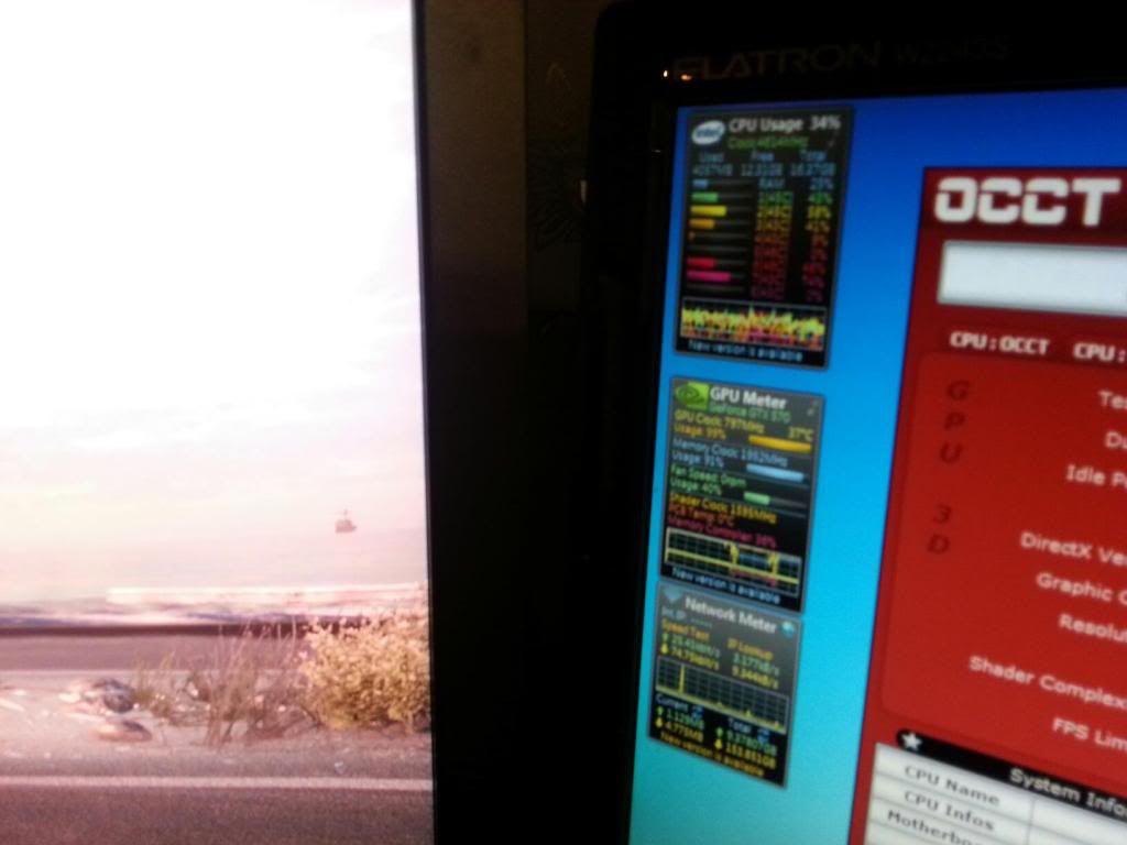

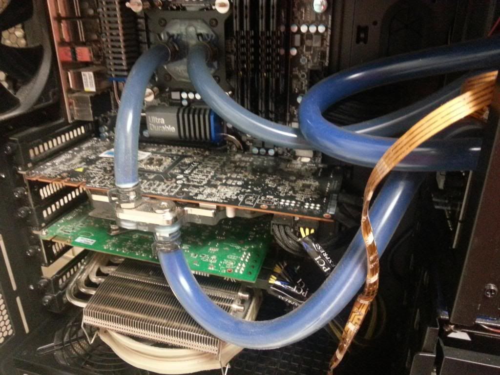

ok so finished, worst part of it was cleaning out the xspc res what a night mare to clean they are.......... another thing i wanted to do this time was add some 90's in my loop one on the res and one on the bottom of the gfx block, next time i do it im going to get a couple of 45's for the cpu block, anyways here is a pic of the loop finished and in game temps
also please excuse the horrible 460 in the pics i need to get a little card for my other 2 monitors its the only reason its there
temps are cpu: 45c in game 57 max 35 idle
gpu: 37c -40c in game maxed 33c idle
amb 21c

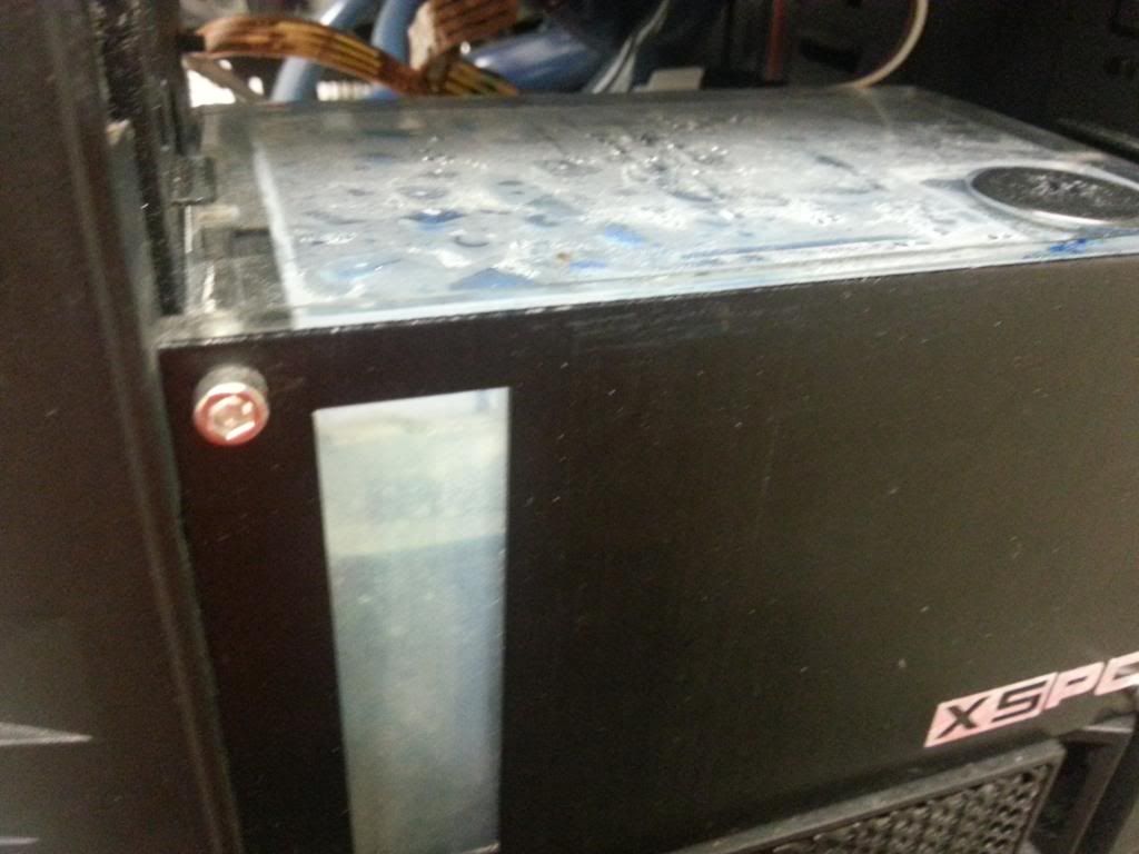

Although a pic of the blocks before cleaning would of been helpful.
Pastel does suffer from wall action quite badly too as anything fluid with a heavy suspension would.
BTW OP do you still have this pastel or have you drained it away? Mayhems may want to take a sample + some of the tubing for testing.
I had mayhems pastel for about 7months without changing it and I only had staining on the hoes, but it didn't go weird like yours.
ok... clear bits up :S your right should of taken pics of the pastel in the blocks when took out.. its wasnt thick like custard its was just a bit thicker than usual, also had changed colour and i was having to top it up everyweek at the end of its life as it was going down about 1cm a week in the res... couple of things that could add to the puzzle is that i dont know what brand the hose was as i got it given off someone.. so it could well have been coming off the hose, also it was originally pastel white but it went grey so i added some mayhems red dye to make it red but it made it bright pink so i added blue to make it purple then added more blue to make it blue.... it looked ok when i did it, over time it turned into this though :S also i dont have any samples for mick its all in the bin now
