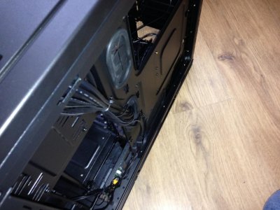

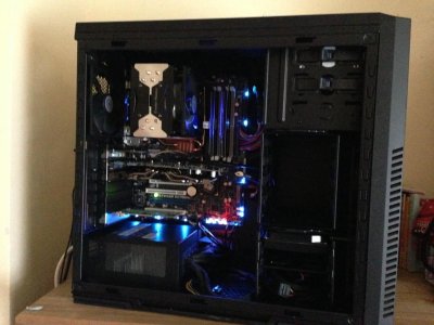

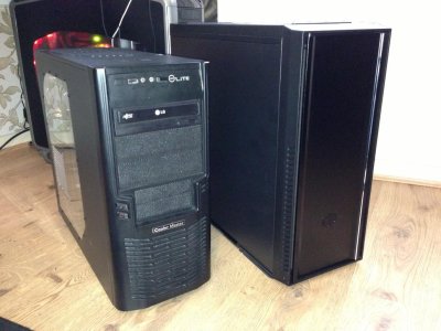

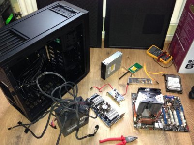

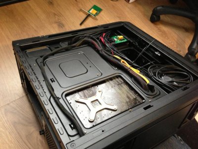

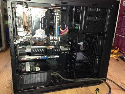

The build was just spare parts for office computer
Cabling was fine would be great if the PSU i had was modular but i'm not to fussed about it in this case as once the side is on it stays on and no windows ect so the internals wont be seen
The case has 3 stock coolermaster fans on a speed control slider,but even on high is very quiet
I have heard good things about the Corsair fans i guess you will use the SP for a Radiator and the AF for case fans
Pics are old case and new,Parts,Cable view and finished
the last pic is me just seeing if old 580 will fit

Looks nice and tidy. I do like the features of the Silencio 650, but I've read some rather rave reviews about the Corsair 550D. There is only £10 difference in the price, and that all aluminium front is kinda winning me over atm.
