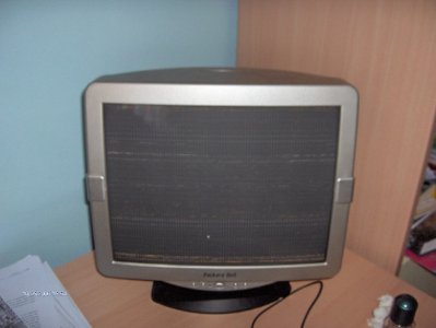

i have a 7800GS i have problems with performance, and btw mine isnt 375 / 660 but 375 /1.2GHZ stock after playing BF 2 i get my desktop and all stuff 4 bit colours and 640*480 resoltion and i have to refresh driver when i oc i get sh*t like a whole screen of lines and errors with nv_disp 4
The make is XFX 7800GS 256MB GDDR 3 375/1.2GHZ help pls

it is good in bf2 only when i press alt tab to switch window iget a brief picture of lines and it is slightly jerking when in a jet or heli @ 1280*960 4x AA, is this cause the card is not fast enough or some ohter issue , thanks for the interest PV
