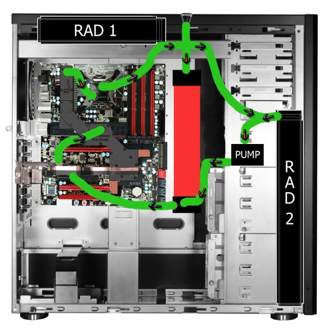

This isn't my first time watercooling, but its my first serious loop. I previously had cpu + Mobo loop with 1 double RAD res and pump. But Ive totally upgraded my system and with it I now need to upgrade my watercooling loop.

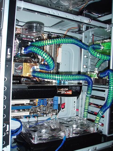

Here is a picture of my old loop, which is a little messy, and what i plan, did a mock up on photoshop.
Let me know what you think, and changes that either need to be made or just might make it a little more efficient. Also is that pump enough?

Not sure how that will work with the res really. Your better off if it just went blocks -> res -> pump -> blocks (and somewhere the rads lol). Just make sure the res is right before the pump.
Basically you shouldnt have the pump turned on without having water going through it, having the res just before the pump (and higher up tends to be better too) means the water goes straight to the pump and keeps it happy
Otherwise looking good, nice setup you have there!

Quote:

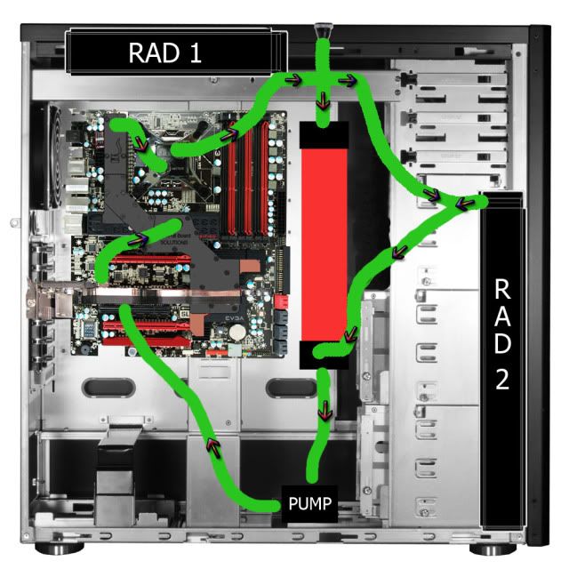

Ok, so if i moved the pump to the bottom would that solve it. then it goes: Pump > Blocks > Rads > Pump.

Yea, that loop would be better General rule is res before pump, but the rest of the order doesnt make much difference at all, just do whatever looks cleanest.
