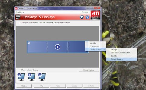

Eyefinity was very easy to setup, just plug in the screens, open up catalyst control panel and create a group. Easy. This now tells windows you have one screen with a 5760*1200 resolution, extends the task bar and starts every program in full screen, which unfortunately isn't ideal.

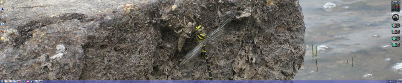

Nice review. The cost is the biggest killer. But I question the amount of detail needed in the two flanking monitors. Imo Ati should decrease the image Quality if possible as the gamer will not be staring at them, they will mostly just be in the corner of the eye of the beholder. Like in reality, the corners of our vision is only really sensitive to motion so we don't need all the detail of a 1920x1200 monitor.
As for cost I got my new Benq 1920x1080 24" for 140GBP so 3x140=420 + hd5770 trifire = 420 + (120x3)= 780GBP all in! Sounds more appealing now!!
That desk top shot looks ridiculous lol, can you post up a random screen shot of your desk top in use. Is it really possible to use the whole desktop with out filling with Task Manager, realtemp etc ...

Indeed that desktop shot is ridiculous. For me - the price is just too much, and it doesn't bring that much advantage. Others may disagree, but I just feel that 3+ monitors can begin to get a little pointless.

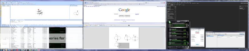

I know what cl0ck_ed means when he says they should reduce the qquality on the other two screens. In some games, like Dirt 2 or grid, you only need the movement to tell you of another car alongside etc. but in RPGs like oblivion, it just helps with immersion having that quality. I would love an option like that so that I could have crysis running all the visuals on one monitor and maybe only mainstream on the side.
About the price, you're right with 1080p monitors, unfortunately I had a very nice 1920*1200 model to begin with, and the 1200 monitors are a bit more pricey. Unfortunately for many people the price will put them off, but after a couple of days playing with multimonitor gaming, I'd struggle to go back.
Its kind of like that initial second monitor, once you go dual screen you don't want to have to go back.
Below is my desktop, how it is normally, with a half monitor devoted to firefox, one to outlook, one to itunes, half to chem draw, half to chem 3d, msi afterburner checking the gpu temps and overclock (900/1200) and the rest to vpn clients etc.
