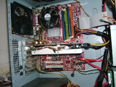

plus have att a picture of the inside of the PC. Hopefully managed to point the camera at a useful bit If not, let me know & I'll try again.
Might also be important (dont know) but I have 2 sticks of 2gb each of RAM, but when I look at System & Maintenance menu of my PC it can only see 2gb.

Send it back,workmanship looks really rough.Get a refund.

Location: Shropshire
Posts: 5,614
idd
dont risk the warranty
send it back
not fit for purpose
etc.
refund and then look at a good retailer such as scan or mesh.
