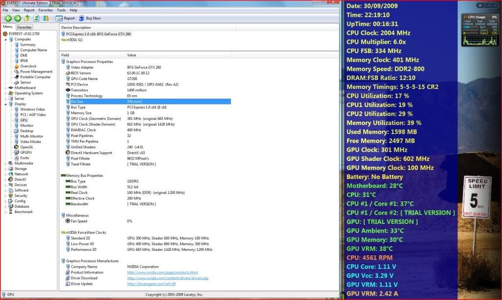

i have a GTX280OCX and having issues with it just the last couple of days.

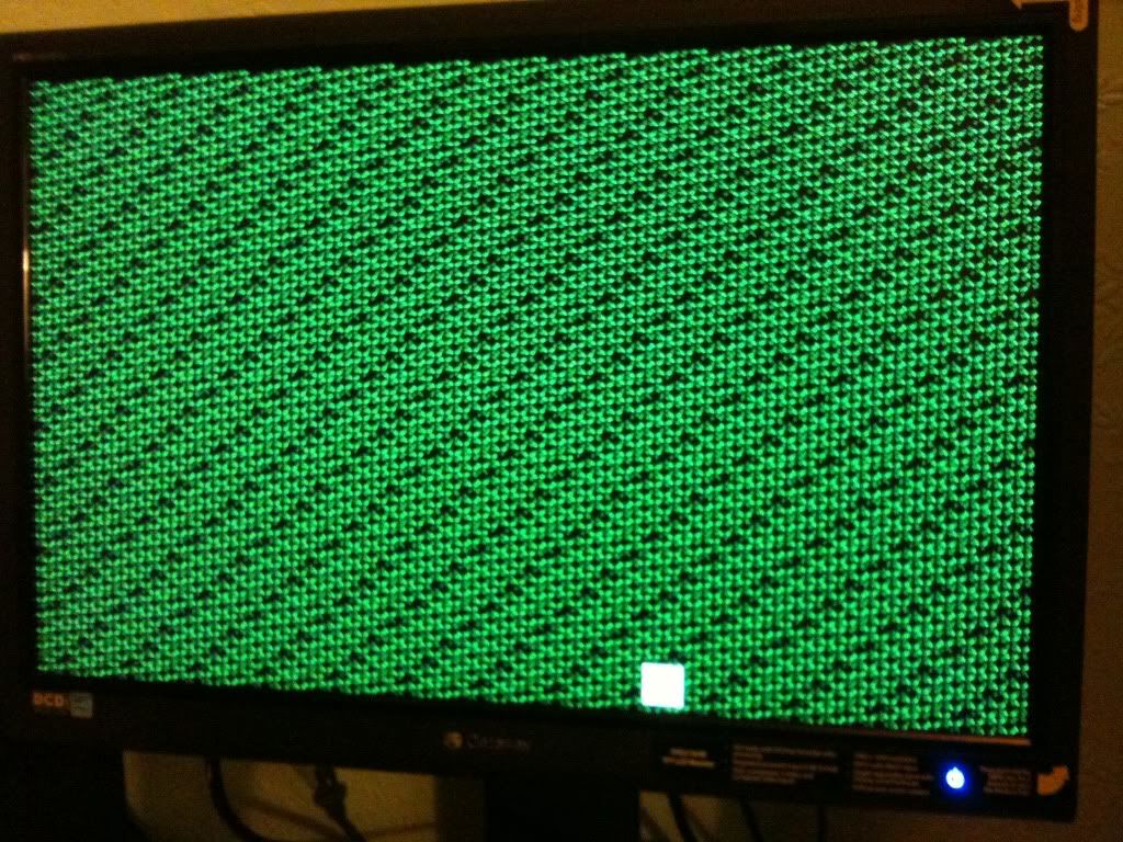

Basically its locking and showing artifacts but full screen, temps are fine under load testing but eventually it will crash during gameplay.

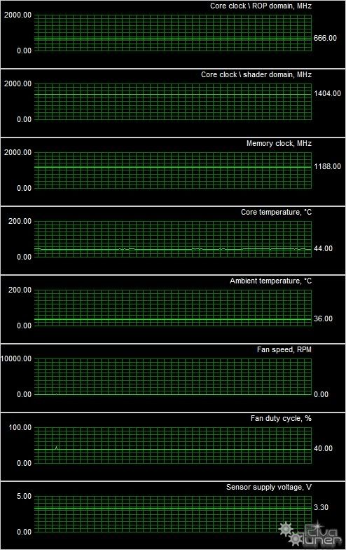

One thing i have noticed when i monitor with Rivatuner is the Memory clock and setting seem to fluctuate, currently when im writing this im showing
core clock = 300.86
core clock shader domain = 601.71
memory clock = 100
run something like Furmark and sometimes it crashes, i notice the MHz shoot up.
Wondering if the memory is giving out on me perhaps.

Ram is fooked - RMA time

Lasher what ur showing in the OP are the 2d settings.
Whilst in 2d it probably behaves itself.
Then u ask it to work and all hell breaks loose.
It'd be handy to know what the 3d settings for it are. In relation to that, although they aren't shipped like it, keeping the shader at 2x the core is generally considered a good idea.

The screen output looks like power/memory issue. This could either be that the heatsink isn't doing it's job or something like some of the caps on the pcb are failing.
