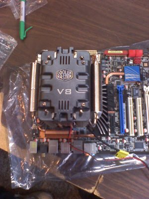

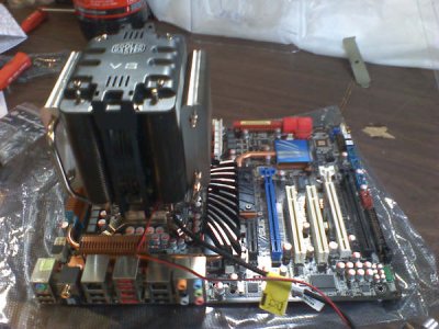

dose it curve upward? what if this is intentional to counter the wieght of the heavier heatsinks and fan combos

i have found a number of post like this most are linking to hs and fan combo
Warped Mobo
After 6 months of usage, due to the way the heat sink is mounted to the mobo, Intel boards are warped so bad that it can actually damage the layers.
I dare anyone to look at a 6 month old Intel mobo and look at the warp for your self.
You won't find this issue on an AMD mobo due to the plate used to mount the heat sink.
posted by : bjbrock, 02 March 2009
