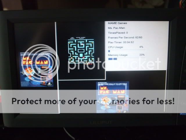

The LCd is going to be incorprated into the CP. The LCd will Give info such as Time played, CPu info, memory Info, Game, Marque, box info, controller options and more. Allso allow for Juke box mode ...
Here is a quick pic of it woking but this software is still being tested.
