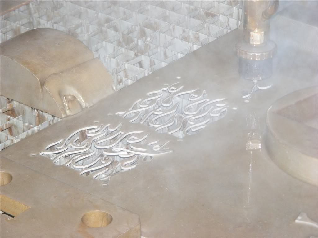

Water Cutting - windows/integrated rad grills/bespoke parts
"The water jet process provides many unique advantages and capabilities compared to other methods of cutting. The process uses water at 60,000 psi to remove material without heat. This cold cutting process uses a supersonic stream of water to "grind" away the small grains of material. A very fine abrasive can be added to the water stream to increase the power of the process many times (called abrasive jet as opposed to water jet)."
ADVANTAGES & CAPABILITIES
Cuts virtually any material (plastics/composites/steels/copper/brass/aluminium/glass/ceramic/stone and exotics such as titanium and inconel)
Cuts thin material and thick (aluminium to 250mm/stainless steel to 100mm)
No heat affected zone
No mechanical stresses
Extremely detailed geometry - no limits on complexity of design
Stack material to cut many thin parts at once
General tolerance +/- 0.2mm
Ability to nest parts reducing material waste (part separation down to 1mm)
Edge finishes are clean, burr - free and without oxidation or distortion - eliminating many secondary finishing operations
Cut out requirement for secondary drilling/slotting operations
No tooling costs
Suitable for small or large production runs
Computer control means easy and very low cost design modifications
The process is environmentally 'clean' producing no hazardous substances or noxious fumes
Integrated roof grills available, custom windows, custom grills, roof and front panel skins, custom mounts and part fabrication
Full cad design service available
Any size job can be undertaken, prices start at £5
