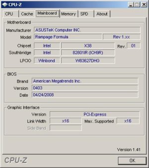

Right, I am sure some of you know that the Maximus and the Rampage are pactically the same board other than the chipset.
Well, people have shown by a quick flash of the bios that the x38 and x48 are very much the same chip.
I have just now flash my Maximus Formula with the lastest Rampage bios allowing me to get at some hidden features high FSB and a some how keep a lower voltage.
Guide can be found here. Scroll down a little.
Enjoy!

I can tell you as a fact this is well worth it.
I have my qaud at 4100mhz with only 1.43volts. Not sure how mind you.
Also I am now able to get my ram to 1200mhz.
I am rather impressed.

This is a worthwhile mod to do, but be aware that this is a one way ticket... I don't believe u can flash back to the x38 bios afterwards.. In the case of an RMA this could prove troublesome..

There is a way back now, so nothing to worry about.

Just grab any Rampage bios and you are off.
I am using 403 at the moment, brilliant.
